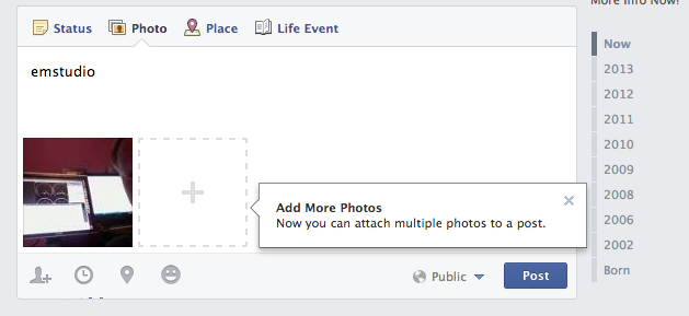

File comment: me pretending to post on facebook
