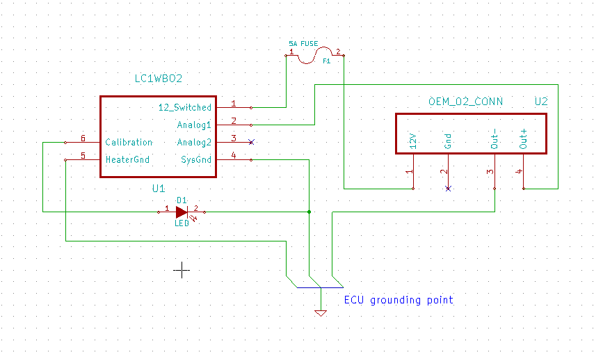

Before I build and install my own FreeEMS board, I'd better pickup an easier training project to practise. I bought a 99 Buick Century as my backup car, so that I don't need to finish my job in a hurry
I draw my wiring work on KiCAD

Study the OEM harness carefully
Draw my layout on paper to clear my idea
This layout is bad, I can't let LC1's ground and O2 signal ground converged too earlier at this point

They must be ground at the same point as ECU were

Idle is smooth and stable, check engine lamp won't light. The LC1 controller is smart enough to heat the sensor. I evaluate the resistance of OEM heater, It is only 5 omg, that's said the alternator must provide 2A+ current during the driving. And insufficient current can cause injectors squirt less than ECU expected, and a knock will be a result. The most significant effect was improving power/torque curve, the power output was more smooth than before and there's no free gaps on gas pedal
