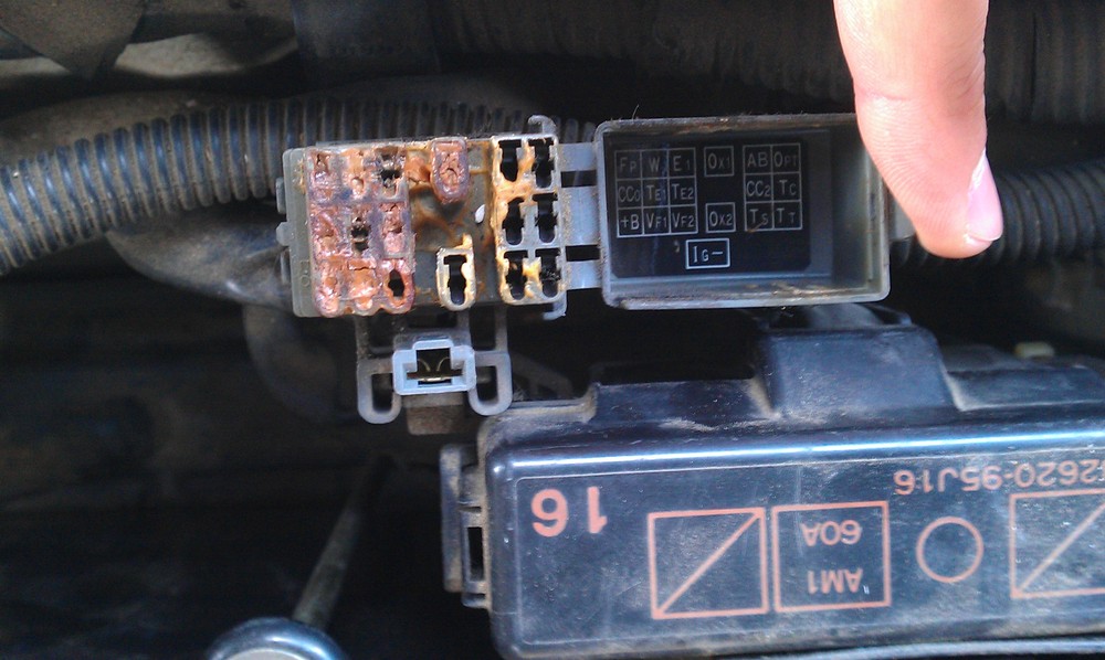

  • Diagnosis port
    How is this accessible and what information might it contain? Can I make anything blink me error codes by bridging some pins or something? (see pic2)

[*]Diagnosis port
Other than being in sad condition, it looks very standard. I forget the connector pins to bridge, but I bet you can. It's likely googleable too. http://pinouts.ru/CarElectronics/toyota ... nout.shtml just for example, from a quick search. I bet you can do better. My terms were: http://duckduckgo.com/?q=toyota+diagnos ... t&kl=wt-wt

"pin out"!!! Stupid me, those were the magic missing words. Thanks!
I couldn't find the exact connector, but this is more like it: http://www.evoscan.com/technical-vehicle-manuals/139
There's also a link on what and how to bridge (pins TE1 and E1). I don't really expect it to give me anything, because the check engine light never went on. Will check tomorrow though. Right now, I don't even know where the ECU sits, to be honest. A little embarassing, but that's why I like having documentation ;) I can read it at night and immediately get to work in the morning.

EDIT: Oh and I forgot: I don't think the connector is in bad condition, it's just the factory protective grease because it's never been used :)

Good news re the connector.
