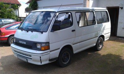

Hello dear friends,
this is a vehicle I'm very attached to, but it's next to impossible to find documentation for.
It's a Toyota Hi-Ace from 1991, originally a 9-seater, nowadays pure transporter. (see pic3)
It's a rare car these days, since most of them have been shipped to Africa. I also know exactly why - because it's the most practical, reliable and fun to drive bus one can own. :-)
The engine is a 2RZ-E, which means it's a 2400cc with 8-valve head, has EFI and 120hp. Afaik, the only other car that was equipped with the same block was a Toyota Hi-Lux, aka Tacoma, sooo... ToxicGumbo, you got some time? :)

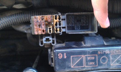

  • Diagnosis port
    How is this accessible and what information might it contain? Can I make anything blink me error codes by bridging some pins or something? (see pic2)

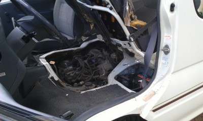

  • Knocking sound in idle
    When in idle (<900rpm), there's a mechanical sound from the engine. Sounds like a rod bearing, so I suspect low oil pressure. When the engine's reving a little higher (>1000rpm), the noise goes away completely.
    What to check first? Where can I attach a pressure gauge? The engine bay is not so spacious (see pic1), I'd rather know beforehand where to look... :)

[*]Diagnosis port
Other than being in sad condition, it looks very standard. I forget the connector pins to bridge, but I bet you can. It's likely googleable too. http://pinouts.ru/CarElectronics/toyota ... nout.shtml just for example, from a quick search. I bet you can do better. My terms were: http://duckduckgo.com/?q=toyota+diagnos ... t&kl=wt-wt
[*]Knocking sound in idle
Why is this not number one? It could be HLAs if it uses them, I'm unsure what it has, though. If it's rod knock, it's not going to be around for long if you're still driving it. Dip the oil, and put the stick in sunlight, it will shine with ultra fine glitter if you have a bearing on the way out. If it's not using HLAs, it could need its lifters adjusting.

"pin out"!!! Stupid me, those were the magic missing words. Thanks!
I couldn't find the exact connector, but this is more like it: http://www.evoscan.com/technical-vehicle-manuals/139
There's also a link on what and how to bridge (pins TE1 and E1). I don't really expect it to give me anything, because the check engine light never went on. Will check tomorrow though. Right now, I don't even know where the ECU sits, to be honest. A little embarassing, but that's why I like having documentation ;) I can read it at night and immediately get to work in the morning.

EDIT: Oh and I forgot: I don't think the connector is in bad condition, it's just the factory protective grease because it's never been used :)

Good news re the connector.

Re fuel pump: There's no relais click when turning on the ignition, only when the starter is (shortly) engaged. Could be the fuel pump relais is noiseless though, but I doubt it ;) I'll have someone turn on the ignition and put my head to the tank... :) Of course, turning on the ignition a couple of times before starting is what I usually would do in such case. Doesn't work with this car though. It's never a bad idea to change the fuel filter anyways.
And LOL your fuel pump is loud as fuck :)

ehb wrote:Re fuel pump: There's no relais click when turning on the ignition, only when the starter is (shortly) engaged. Could be the fuel pump relais is noiseless though, but I doubt it ;)
Brief English lesson: Relay singular, relays plural. The relay might be remotely mounted. Mine are :-)
This may be necessary, see below. Don't get run over! If you find it doesn't, but you think it does when you hit the starter, pull the trigger wire off the starter so that you can turn the key without the starter turning and try again. Some cars have weird wonderful ways of controlling the fuel pump that don't make a lot of sense.
Sure.
And good for 900hp. And almost solid mounted to the deck frame. < the reason. Yours is dangling inside the tank on a bracket that isolates it, and which itself is isolated from the tank, in a tank that is isolated from the body/chassis. If those things have a chassis, that too is isolated from the body. And your pump is good for < 200hp :-)
