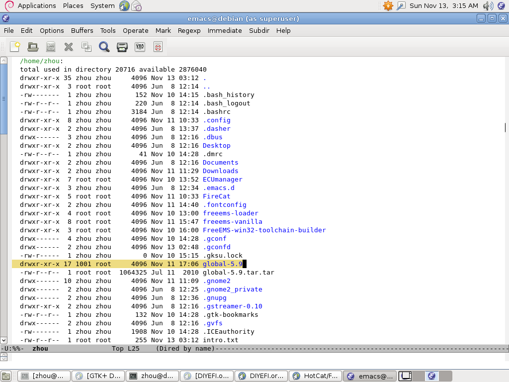

1.First download GNU gtags package

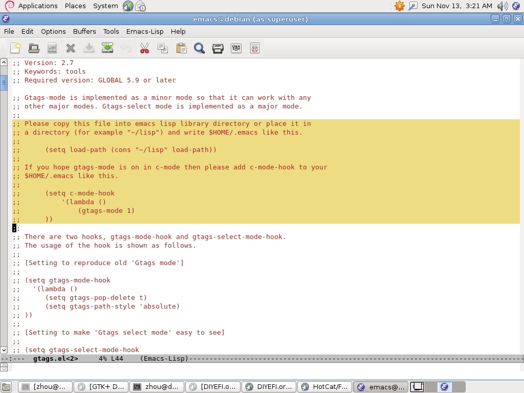

3.Locate gtags elisp extension file and open it

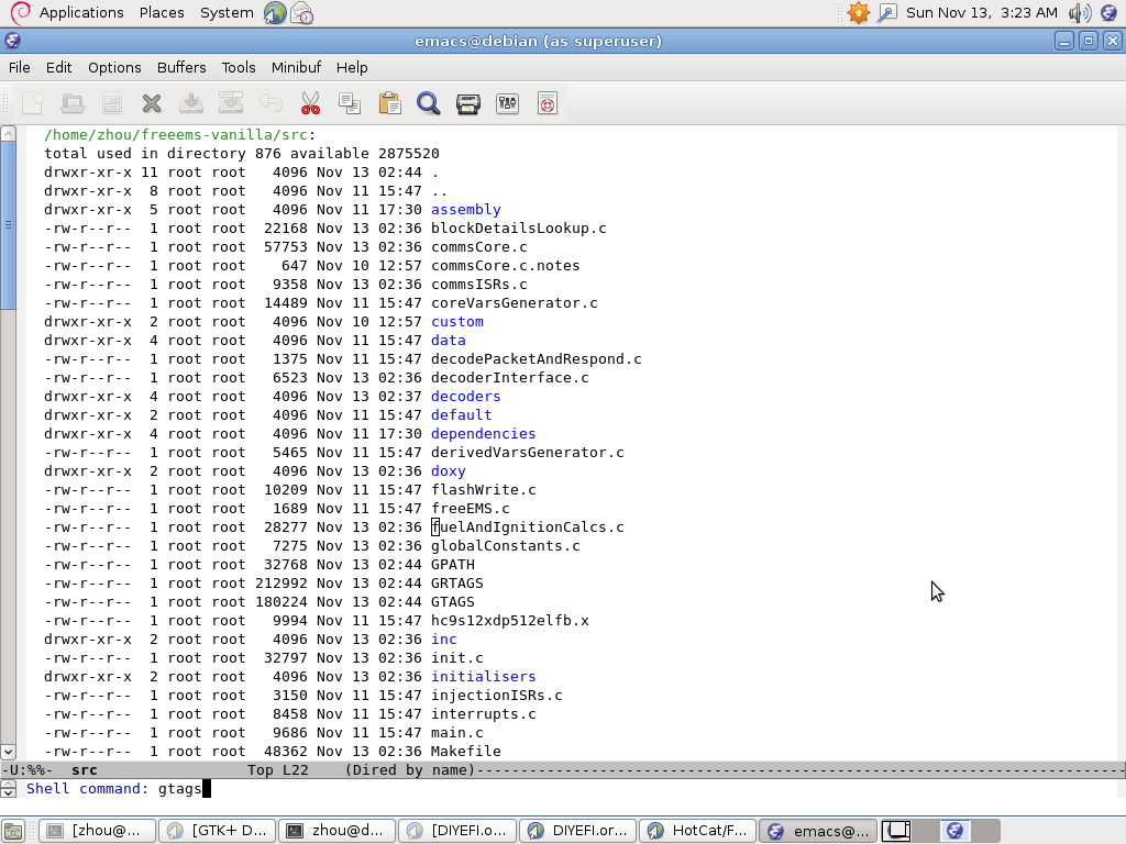

5.Navigate to FreeEMS source directory and run shell command 'gtags' from Emacs

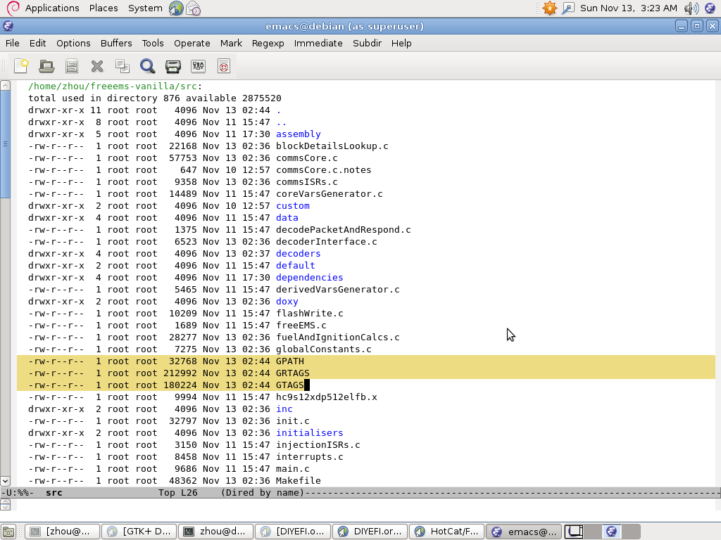

6.Three file should be generated

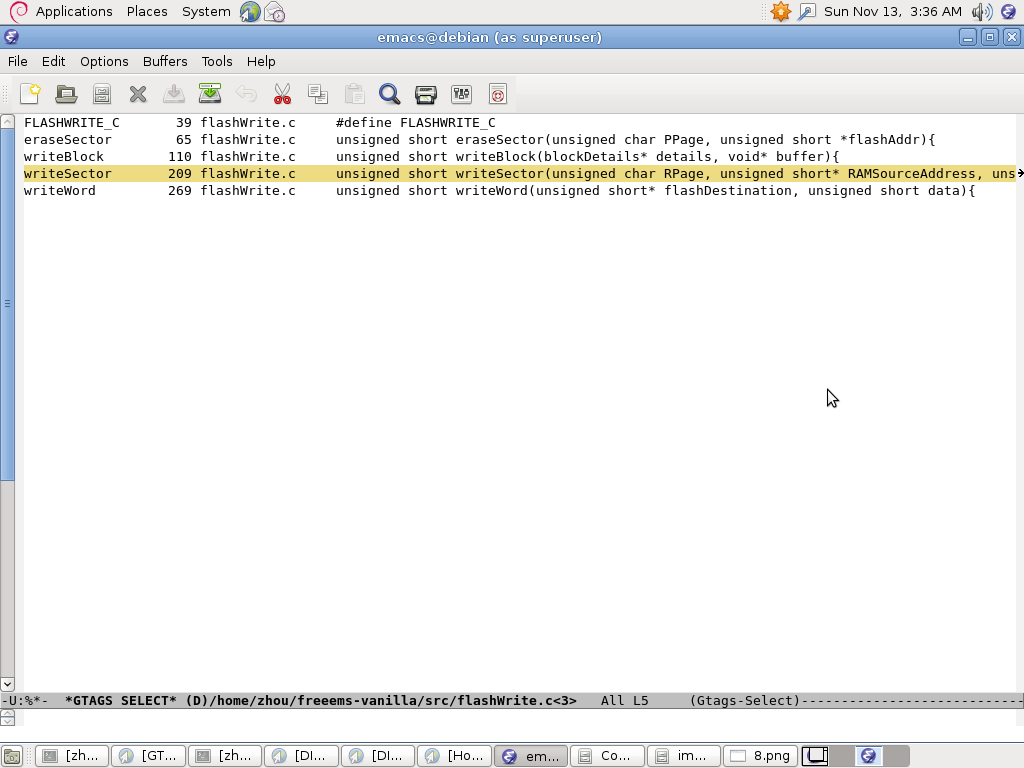

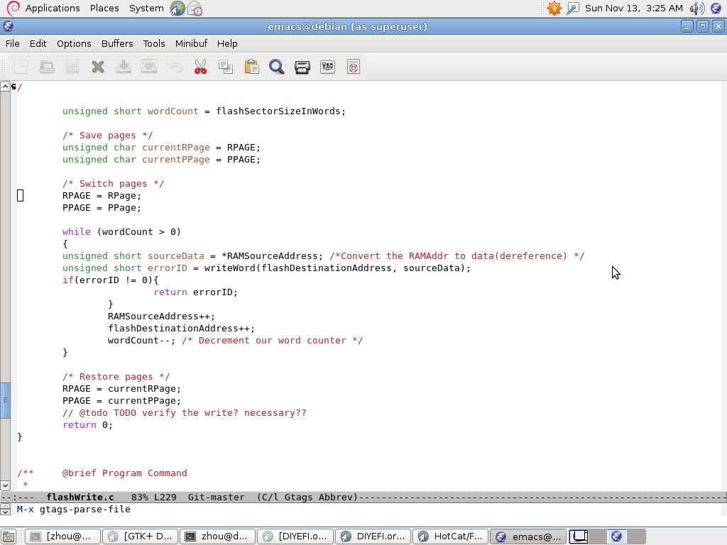

7.Explore what gtags can do with our source code, use 'gtags-parse-file' command to list C functions in a C source file and locate the function body
Press 'enter' key to locate the function body

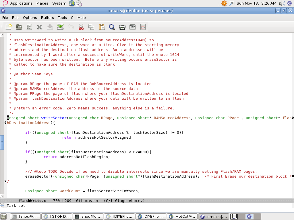

here it is

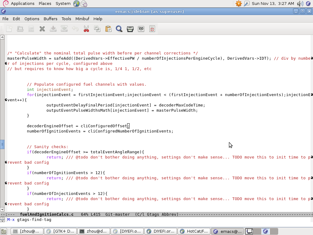

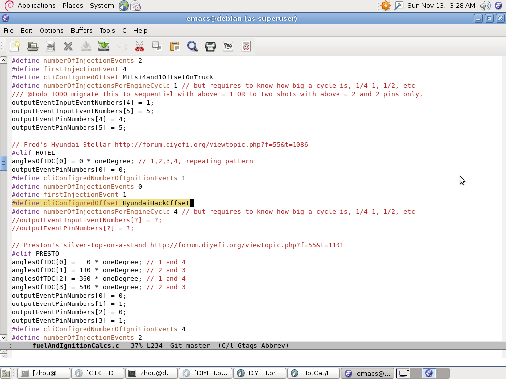

8.Find the macro definition of 'cliConfiguredOffset' using 'gtags-find-tag' command
Place cursor around the 'cliConfiguredOffset' variable and issue 'gtags-find-tag' command

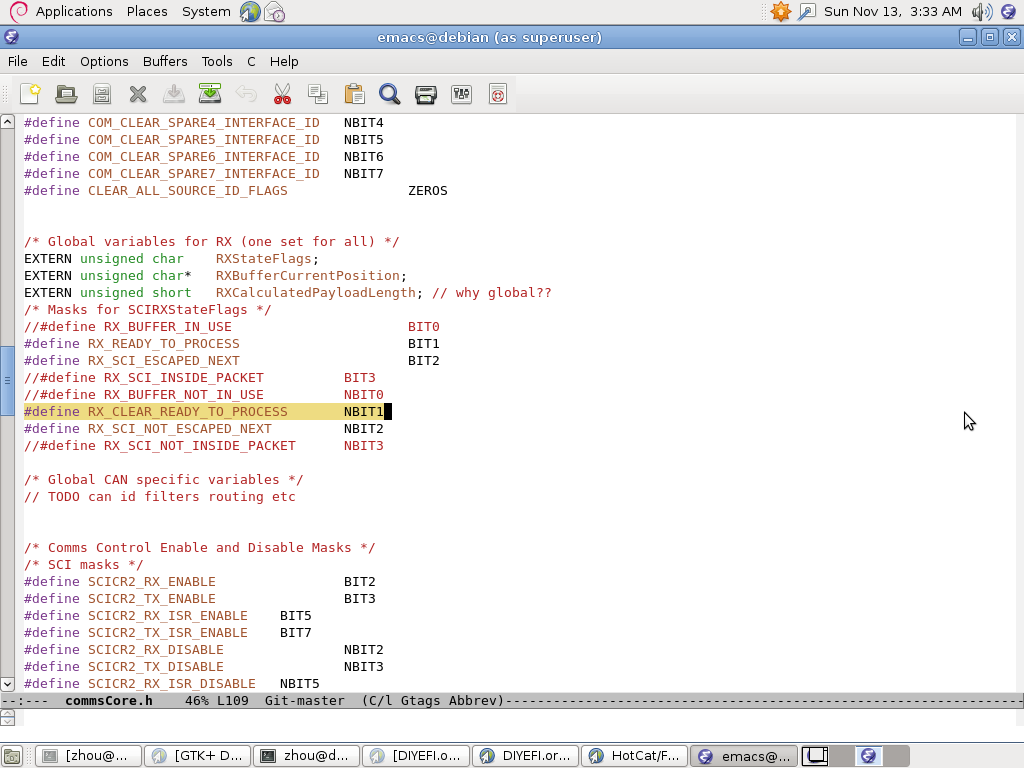

Press 'enter' key to locate whatever definition you prefer to see
See how it was defined for Hyundai

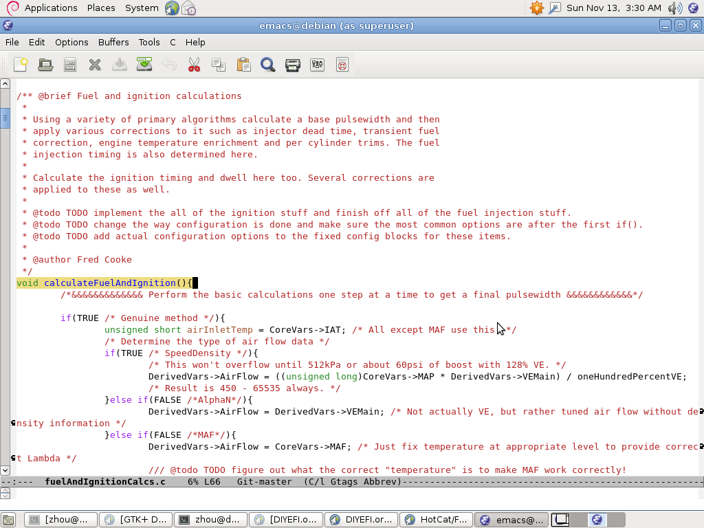

9.Find the definition of 'calculateFuelAndIgnition' using 'gtags-find-tag' command
Place cursor around the 'calculateFuelAndIgnition' function and issue 'gtags-find-tag' command
here it is

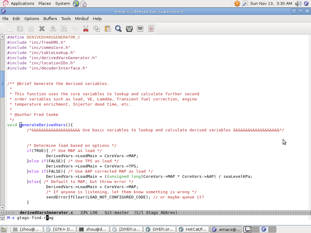

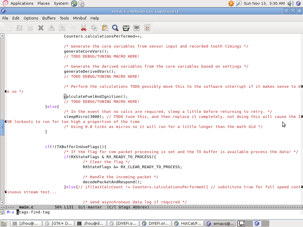

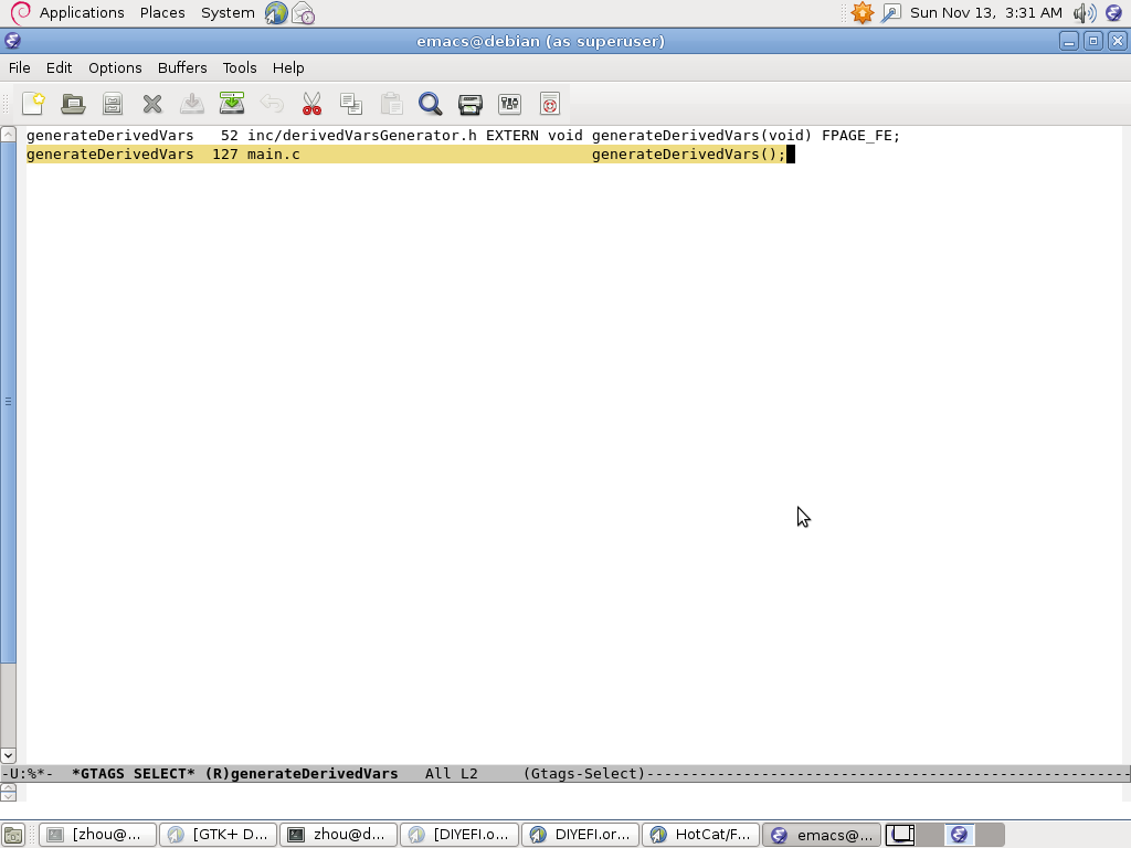

10.Find how the function was referenced using 'gtags-find-rtag' command
Place cursor around the 'generateDerivedVars' function and issue 'gtags-find-rtag' command
There maybe a few candidates, press 'enter' key to choose which one you love it
Here it is

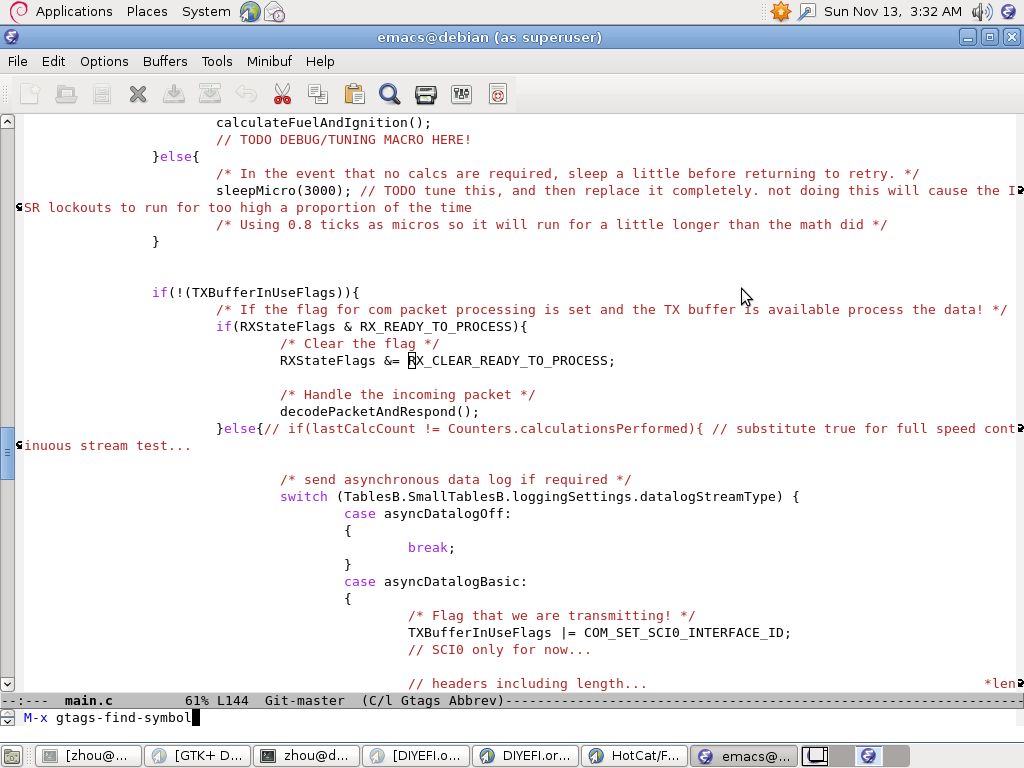

11.Sometimes you have to use 'gtags-find-symbol' command to locate some macro definition
When 'gtags-find-tag' command does not work, try this one
you must choose
Here it is
