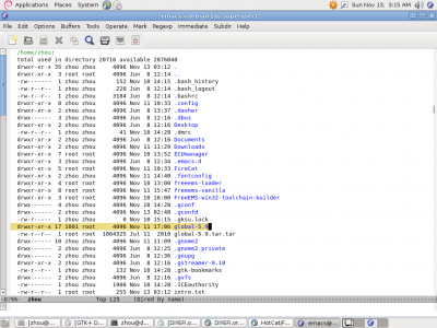

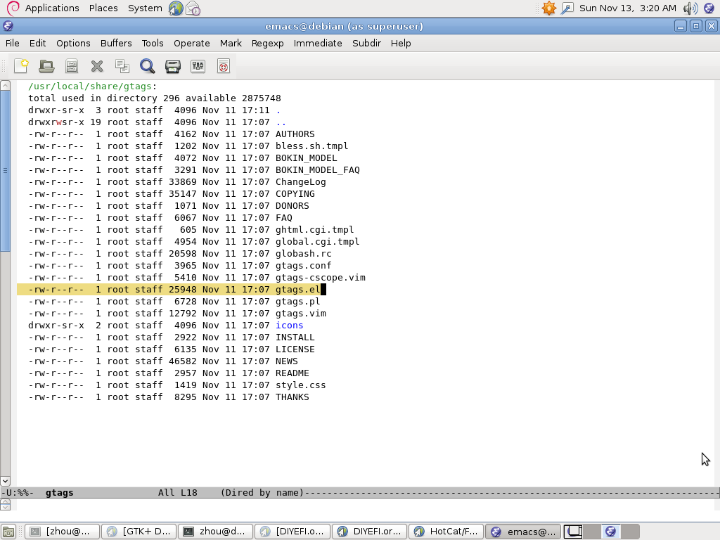

3.Locate gtags elisp extension file and open it

4.Follow the comments to configure your emacs

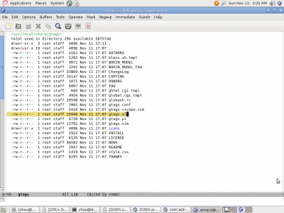

5.Navigate to FreeEMS source directory and run shell command 'gtags' from Emacs

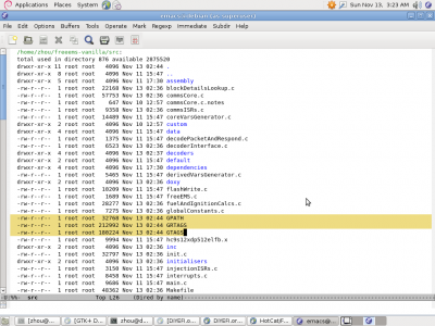

6.Three file should be generated

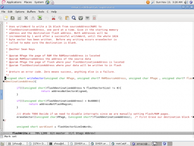

7.Explore what gtags can do with our source code, use 'gtags-parse-file' command to list C functions in a C source file and locate the function body
Press 'enter' key to locate the function body
here it is

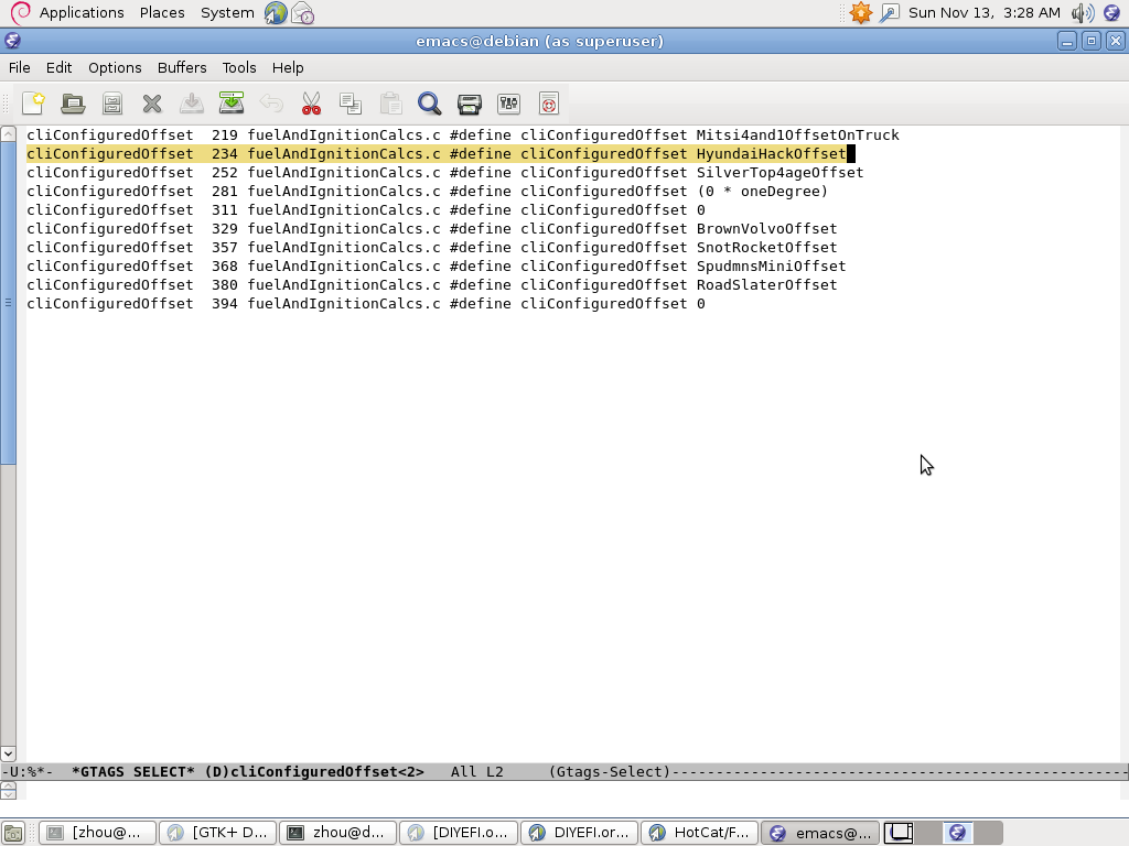

8.Find the macro definition of 'cliConfiguredOffset' using 'gtags-find-tag' command
Place cursor around the 'cliConfiguredOffset' variable and issue 'gtags-find-tag' command
Press 'enter' key to locate whatever definition you prefer to see
See how it was defined for Hyundai
