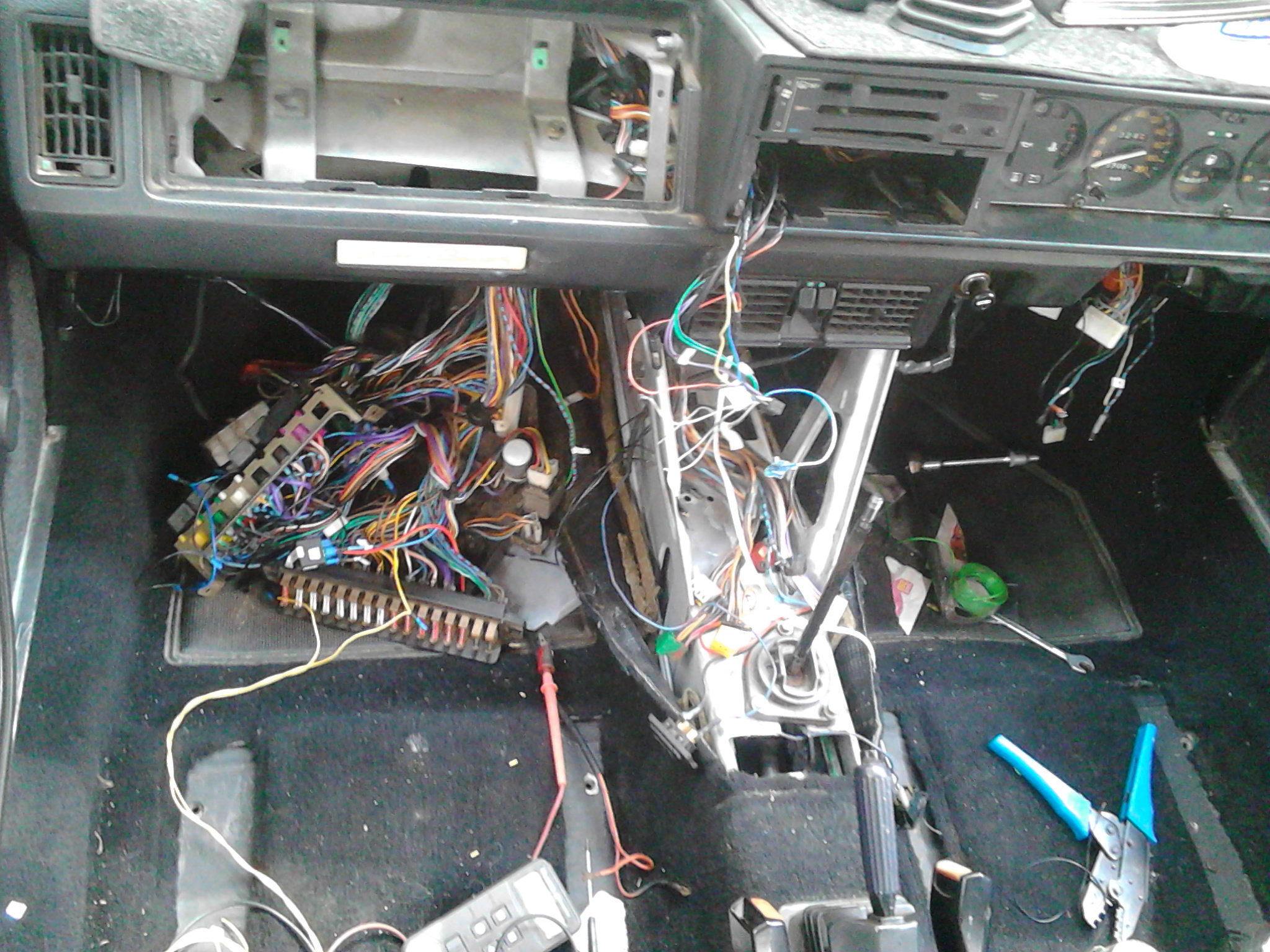

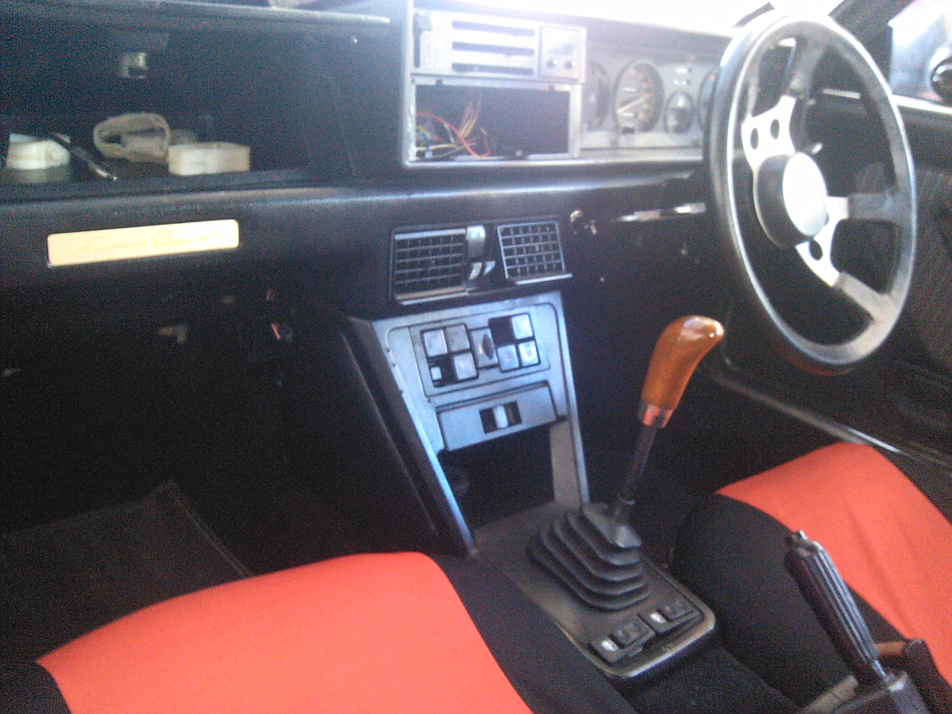

Progress halted as my other project car blew up. But while I'm waiting for the engine to come back from the machine shop (much delayed) I was able to do some more work.
Some before and after pics of the interior. Behind is new brake and clutch masters, new reservoirs, new heater matrix, repaired vent controls, and a whole bunch of wiring changes and extra relays.
