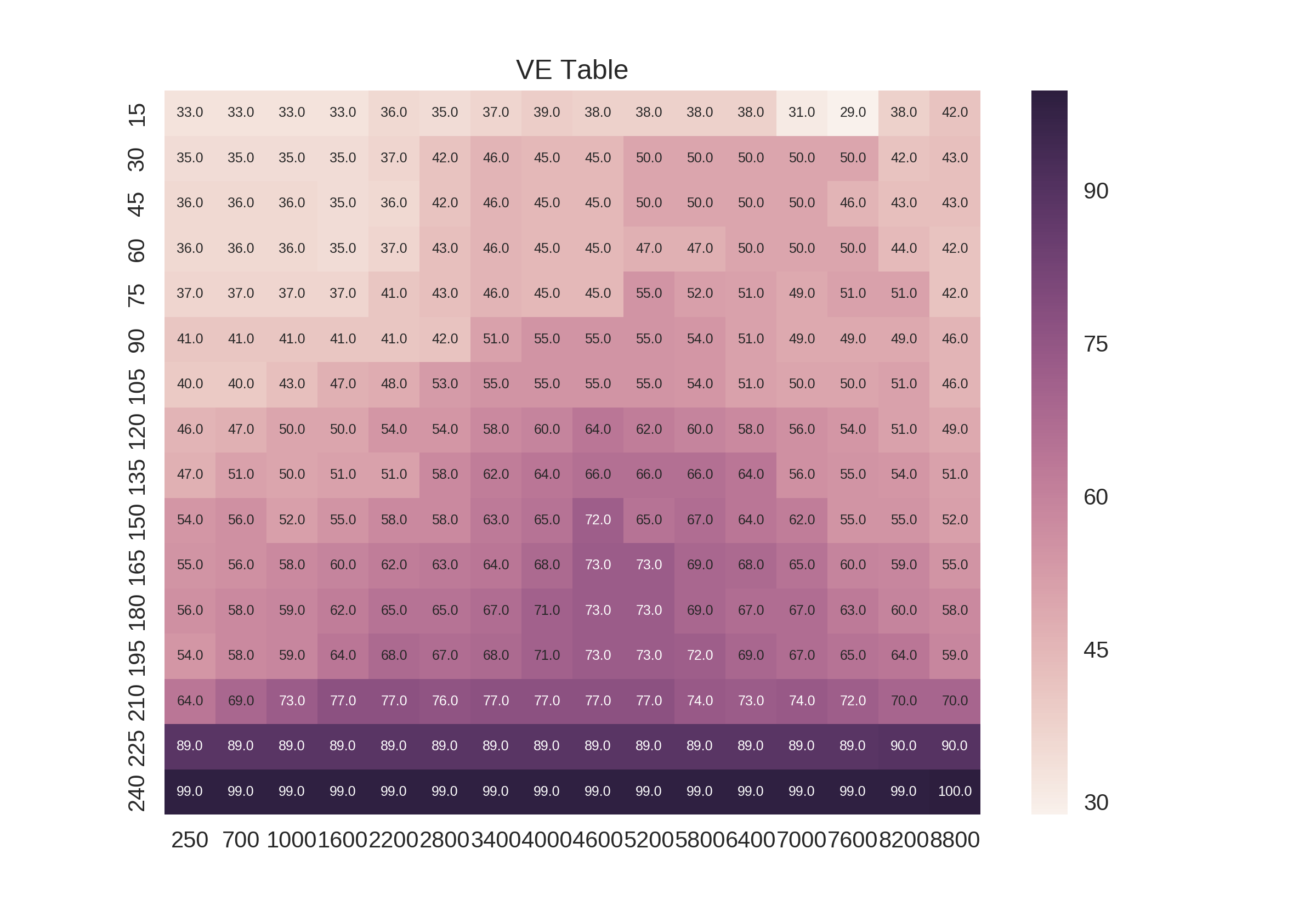

Hacked the script to look for LR() instead of AP() and got this:
With this difference:
On the first run I fed it tables from the wrong checkout/base tune. The script didn't seem to notice that the base table was different from the table within the logs. It should probably check and warn if the log is for a different base tune.
Very cool tool! Will chuck through some longer logs when...if I ever get some.

Yeah ideally it would process the raw log files rather than require exporting as csv. Basically it will work with the way I have set up my engine (eg AFR table has same dimensions as VE table), and if by chance yours is the same then it should hopefully work.
My AFR table uses the 'AP' macro, so that is what it is looking for when reading the table https://github.com/johnhowe/haruspex/bl ... pex.py#L62
There is a simple check that the data is AFR rather than lambda before converting, so by switching to 'LR' and giving lambda values should still work as expected https://github.com/johnhowe/haruspex/bl ... pex.py#L65
Thu Jun 30, 2016 2:09 am
Posts: 15216
I reckon the CSV aspect is OK, as you would often want to trim your log, just as we did last night, cutting off 90% of the front full of tuning changes.
Good to know it handles petrol AFR and lambda equally well :-) Reminds me why the macro is AP and not AF or AFR, too :-)
The big issue in my mind is that it was happy applying a generated diff from the log file to a completely different table input and telling the user to apply that table to their tune. I guess predicting the future based on intestinal matter isn't always accurate, but I reckon you could do better :-D
