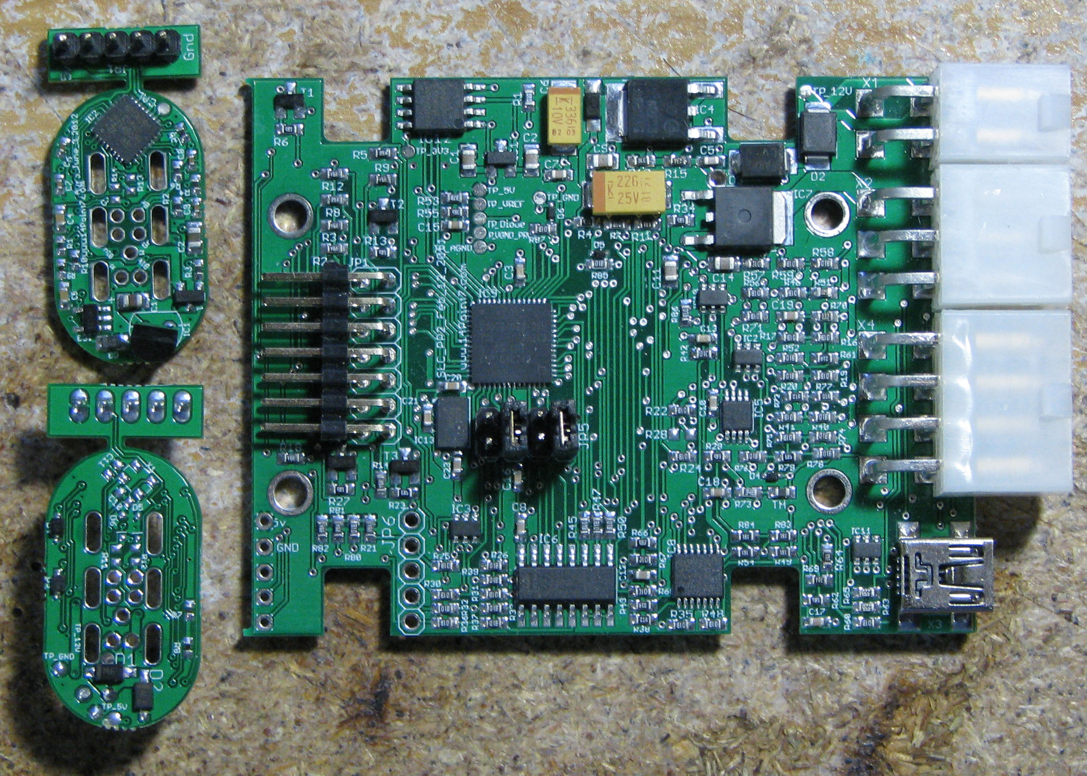

I am a bit gun shy with spartan, my primary limitation with spartan was space constraints so everything is "spartan" however that can be mistaken for me trying to cheapen out on the number of components. My SLC PP2 unit better visually showcases the quality of my work, I think you could take a 5 second look at SLC PP2 and make a reasonable estimate of the quality.HelmutVonAutobahn wrote:In the big drawer are:
I was just going top order a "spartan" I figured it would be the cleanest representation ?
Attached is an image of spartan (top side and bottom side) and SLC PP2 (without the display attachment, there are no components on the bottom side)
In the picture spartan has the calibration and programming header attached, I cut that off once the unit gets programmed and passed quality checks to get it to fit into the sensor connector.

Alan, without asking you to give away secrets, you often mention protection circuitry and so forth when reviewing other designs. This is very much after my own heart when it comes to PCB design. Can you list what the Spartan is and is not protected against? IE, what can it withstand, and what might damage it? /me goes to check the site. Nope, fair questions, not listed. Could you give the same specs for the PP2 unit pictured above? These specs would make for a nice comparison with Helmut's findings, IMO.

That looks like a MUCH more professional and thought out PCB design than either the PLX or Innovate parts. Congtrats on out-hustling the big guys
The layout style is actually similar to the LC-1.
I can't read the part numbers. But, right away it loos like there is a big Schottky diode and TVS on the input power rail. And, what looks like a smaller TVS array near the USB header ?
I didn't notice a ferrite bead near the USB. Are you using USB power as a signal only ?
I am split on the use of modern automotive grade tantalums vs aluminum caps.
On the spartan, you must get a lot of functionality out of that CPU. I assume it is one with the switched capacitor analog front-end ?
Nice work
