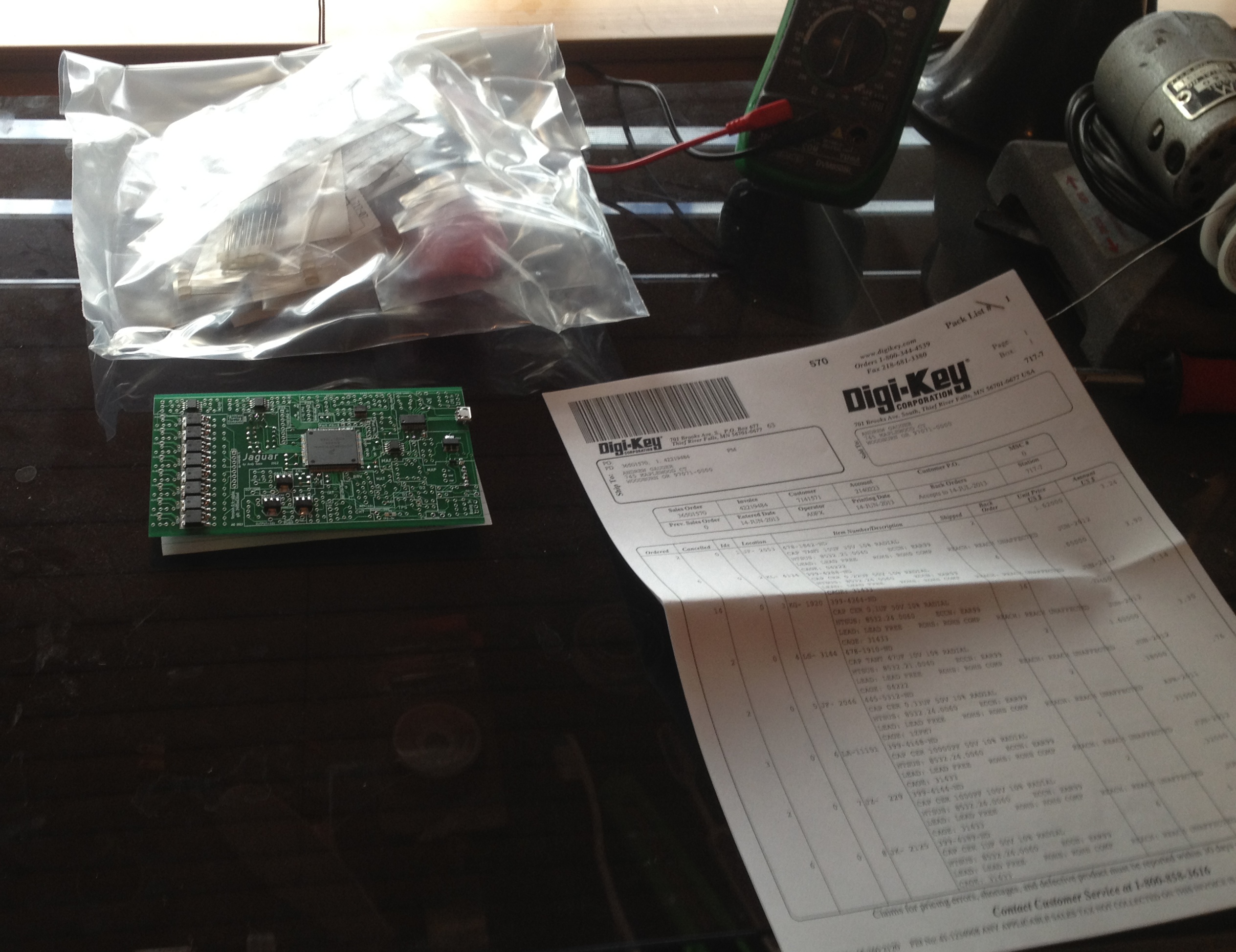

Well, Andy has shipped the Jaguar 0.4-alpha board with MCU and drivers mounted.  DigiKey has shipped the components to complete the board.  I'll need to get the case and connector figured out before the car becomes a daily driver (which won't be anytime soon due to Electrically controlled transmission requirements) but I will have free ems running my engine before the end of summer!  Look out.

The board has arrived.  This is the first of the creepy semi-reflective picture line.  At least you can see I'm happy.  By chance I got serial number 11.  Very nice touch with the handwritten 3x5 card.  I hadn't realized how small the PCB would be, since I was looking at the preview pictures on a 24" monitor.  By the way the solder job by DeuceEFI is tits!  Will my .063" 60/40 clear flux solder be sufficient?  Only time will tell.  Tracking on the component order isn't posted yet, so probably mid-week I can get started.

No, pick up some 0.7mm wire or you'll have trouble. 0.5mm is a pain because you have to feed it a lot. 1.0 is too big, but barely usable in a squeeze, 1.6mm is HUGE and not useful.

Thanks for the advice Fred, I'll pick some up.
In the mean time I figured out a compromise... ROFL
So thanks to Deuce for the Radio shack lingo (I do have a Frys on my daily driving route so I'm not all the shack). I just love the auto feed solder of 1.6mm above. I asked the attendant to help but he actually turned out to at least not tell me the silver was a good idea.

I used 0.032" diameter 60/40 rosin core solder to mount the components to the board, Radio Shack part # 64-005 E
I also used MG Chemicals Catalog Number 8341-10ML No Clean Flux Paste for the surface mount components in addition to the above solder.

OK, so for the board, I've cleaned up my office which has been set up with a bench.  Here's the space:
I've also received the package from Andy, and just now the components from Digi-key. No disrespect Andy, I just wanted to make sure I got all of them easy to sort, and it's easier to claim business expense from Digi-key than Drunkards Pike. Here's the jaguar sitting in front of the unwrapped package Here I've shown just how many sub-components are required to complete the project. One by one I added the reference number in the bottom corner of the packaging onto the BOM worksheet, validating part numbers and quantities. I used a sharpie to mark the package with the first reference the part is used. Here's a picture of the sorted materials.
I added each reference number to the spreadsheet, to confirm that I got every line item, and referenced the pin when the component is first used (which is the sort order). My bench looks very nice, but it got too late to actually get to work. I have .7mm solder hooked up to the bench grinder, desolder flux, and a new tip for my iron.
