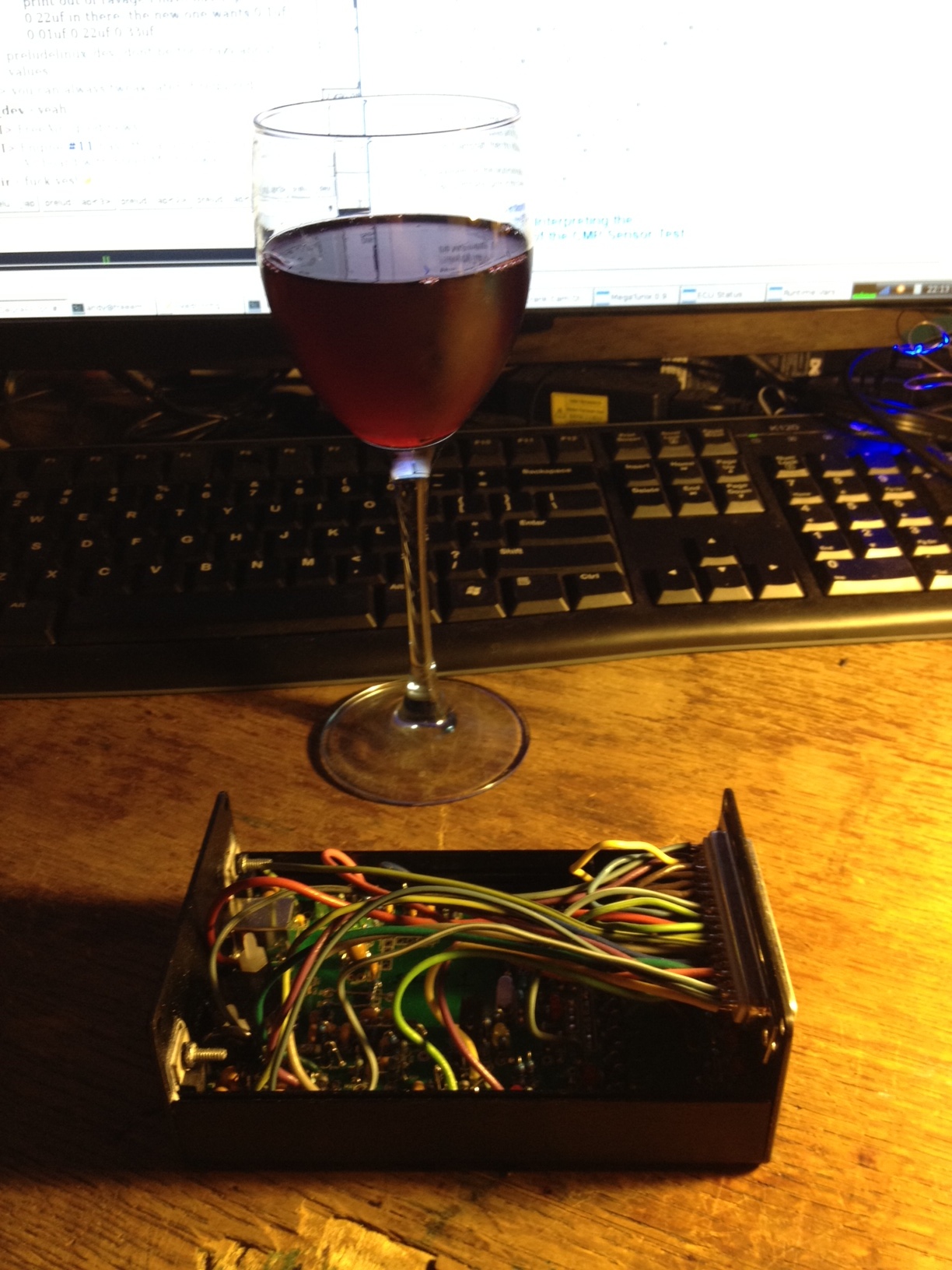

Jaguar A3 after a successful run on my 3.1L V6 relaxing with a glass of red wine in front of my development computer.
Re: Engine #11 Andy's 1996 GM 3.1L V6 in a 1932 Ford Coupe
Once again, congratulations on your efforts and achievements! :-)
I have a few commits and documentation things to get out of the way, but getting you some advance really needs to be number one after those things, as it's not really functional until then. So this is my commitment to start developing a GM DIS specific decoder for you. I'll let you know when I start on it, hopefully within a week. You can test as I go, if that suits you :-)
Nice photo, too! :-)

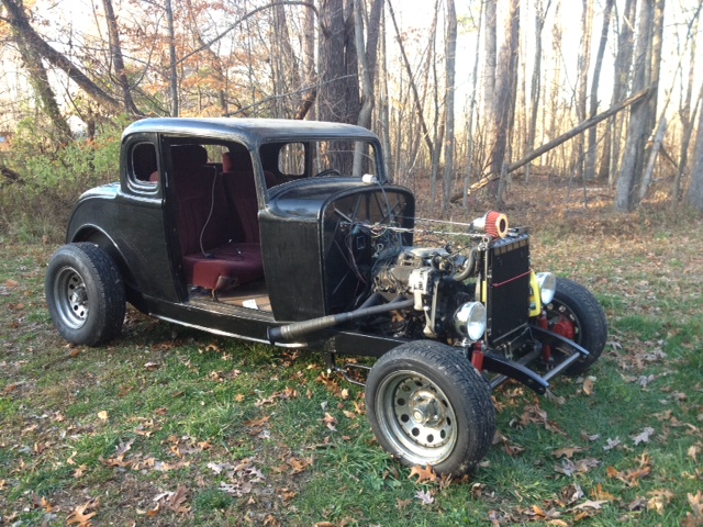

A photo of the car :-)
