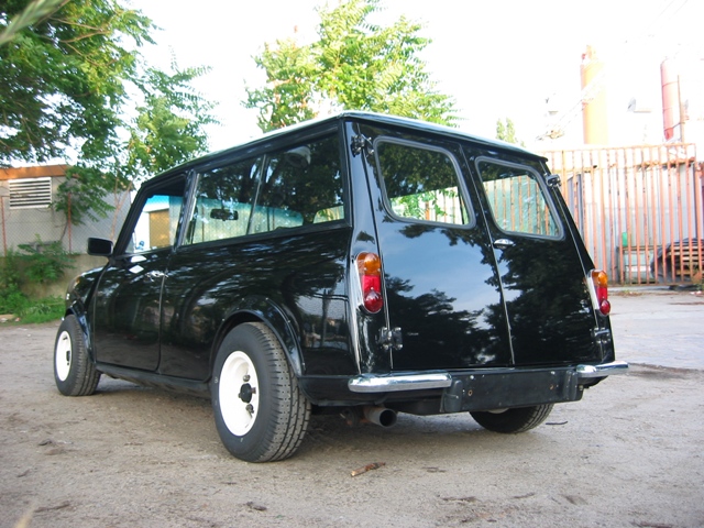

Due to recent demands, I present one of my rides that's in desperate need for an EFI system.
It's a Mini Clubman Estate with 1300cc A+ Series engine, fitted with a HIF44 carb.
The pictures are from when I bought it over eBay, without having looked at it. It was just *the* car I was wishing for back in 2004. Fortunately the car was in the shape the pictures were promising.
I don't have any recent pictures, because I kind of abandoned it almost four years ago. It used to run like shit lately, and in 2008 I got myself a '88 Honda CRX as winter ride (really cheap). Turns out it runs well all year through, so there was no need (and no time really) to fiddle with the Mini. I'm just not the carb guy, and I don't know any.

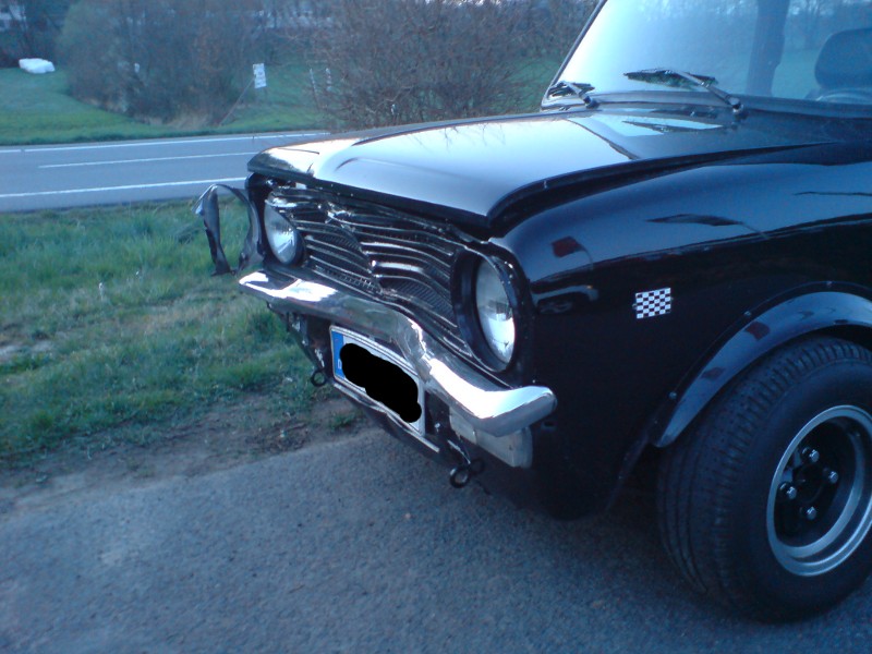

Some more pictures... It wasn't my fault, the other guys insurance paid all damage.
Edit: Oh! Now, looking at the post.. No, it wasn't the chevy that squished the mini :) In fact it was a Honda Civic.
I just liked the picture so I posted it too ;)

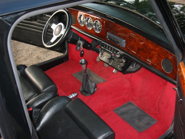

  • Funny stuff the pre-owner put in: electric windows, remote door locks (need work), Recaro leather seats with butt heating (not yet hooked up) and even decent speakers. All things I personally wouldn't need, but they're good for a laugh with passengers.
