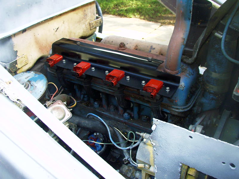

nimblemotors wrote:I'm currently finishing up conversion of the ignition to a distributerless coil-on-plug setup,
which I will show when its finished. (well ok, here is a pic.. :)
