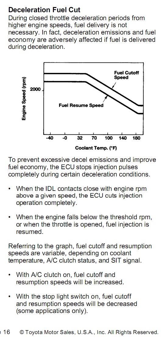

i searched the forum for deceleration fuel cut off system but found nothing. can some one point me in the right direction?

Last I recall the fuel calcs have room for such feature(s), however I believe this feature is not currently implemented. Emissions hasn't been a primary motivation, and has so far been in the backseat with power and track day fun features taking the steering wheel. As a good note, there isn't anything stopping emissions from jumping in the front seat and taking the wheel for a while. So if you have software skills, I'd recommend doing a git clone, and adding such a feature then sent the changes Fred's way and see if he'll include them in the official repo. So far the software motivations have been engine makes yo got, brakes make you stop.
Re: deceleration fuel cut off system
That'll be fairly trivial to implement when the time comes. As Jared said, at the moment, the focus is solidly on getting core functionality up to a world class state.
