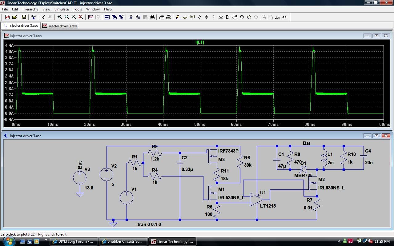

If you could read the voltage across the 0.01ohm resistor under the protected FET that will help to determine the current going through the injector, and make sure its actually peak/holding with your injectors.

Re: Injector Control Options
That was my original design to use PWM from software for peak/hold and on off for saturated. But Fred indicated he didn't really want to do pwm in software so I came up with this instead - technically this IS pulsed - if you stick the circuit in a spice simulator the mosfet is being driven above and below its switching threshold quickly, so it IS actually tuning on and off quickly - it just doesn't require special software to do it - and isn't going all the way to 0V and all the way up to 5V. I suppose I should actually calculate the REAL power dissipation rather than looking at the peaks and making an educated guess. If the software PWM frequency is reasonably similar to the frequency being generated by the opamp feedback circuit you could use the mosfet directly with the same snubber network and cut out the dual mosfet a few resistors the opamp etc.

Back on pg 6 it appears Delta's picture went away. Perhaps it was moved or renamed? I was trying to find it and take a look at it because it's the more revised version. Any chances it can come back?
I cached it here :
http://i260.photobucket.com/albums/ii15 ... 3vkiet.jpg
