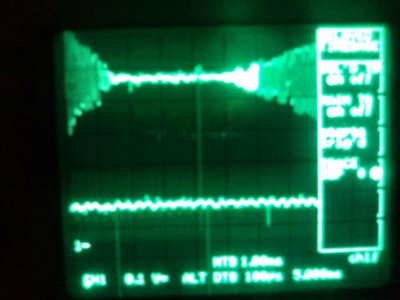

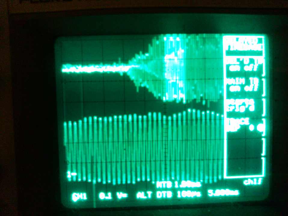

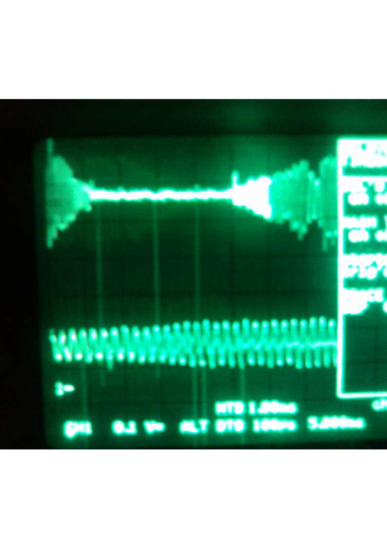

With relevance to the discussion on IRC, this is what I see on the TX twixt CPU and isolator. The amplitude is about 5v. Excuse the ancient scope.
Re: Neil's belated and painfully slow 0.4 alpha build
And on the other side?
AncientGeek
- Posts: 67
- Location: South Shithole
On the other side there is life, Jim, but not as we know it. WTF is that?
If I jumper 2 and 7 I get serial data in Cutecom. But I don't know if its valid data.
If you jumper, you need to do several things:
1) Connect in and out for the CPU TX line
2) Connect in and out or the CPU RX line
3) Connect the grounds together, or you'll get nothing useful.
But I'd say that because it's putting something out, you've just got some solder or flux or piece of wire or something corrupting that signal line on the output.
Did you look for successful sent packets from the PC to the CPU?
