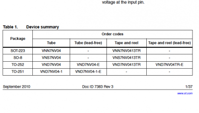

Andy, thanks for your information.
Sorry that I did typo. I should type VNN7NV04 (instead of VNN7NV94)
NN7NV0413TR is the tape reel version of the same transistor.
ST just made their component too complicated

That's pretty standard across manufacturers - suffixing parts differently for packaging. Usually the data sheet tells you, though I ran across something recently that didn't.

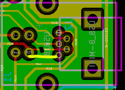

Just another note: the USB-B mini connector pinout has one incorrect trace, if you look at the board in KiCAD, the trace that goes to the lower pad in the row of two vertical pads should actually go to the lower pad in the row of three vertical pads. On my board and Fred's board I cut the trace with a knife and we will need to solder a jumper wire between the pads of the USB-B and USB-B-mini connector as shown in the attached image. The black diagonal mark on the ft29 trace shows where to cut, and the yellow hand drawn trace is the correction.

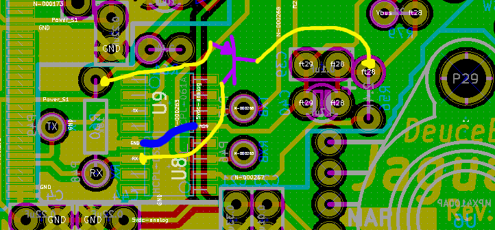

Here is the PNP USB modification if you don't use the Opto-isolator circuits:
See the attached image...
The blue hand drawn line is to connect the MCU ground and the USB ground together, just use a piece of jumper wire soldered to the two pads of U8 and U9.
The yellow hand drawn lines show the connection points for the PNP transistor (I used a 2N3906 transistor). This is necessary to pull the RX line of the MCU high if the USB cable isn't plugged in.
PNP Transistor connections:
The Emitter goes to the +5v side of R60.
The Collector goes to the RX side of R60 or the RX pad of U8.
The Base goes to 5v-USB side of R56 (this is powered only when the USB cable is plugged in.)

Thanks Andy. Very neat drawings.
