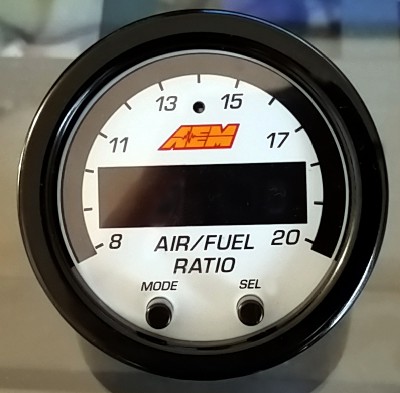

I have no idea. It uses an LSU4.9 sensor and it included a bung to weld into the exhaust as well as a spare face in white.HelmutVonAutobahn wrote:Is that the old 30-4110 or the new 30-0300 ?

Does it have the two buttons n the front face ? Like so... ?I have no idea. It uses an LSU4.9 sensor and it included a bung to weld into the exhaust as well as a spare face in white.
