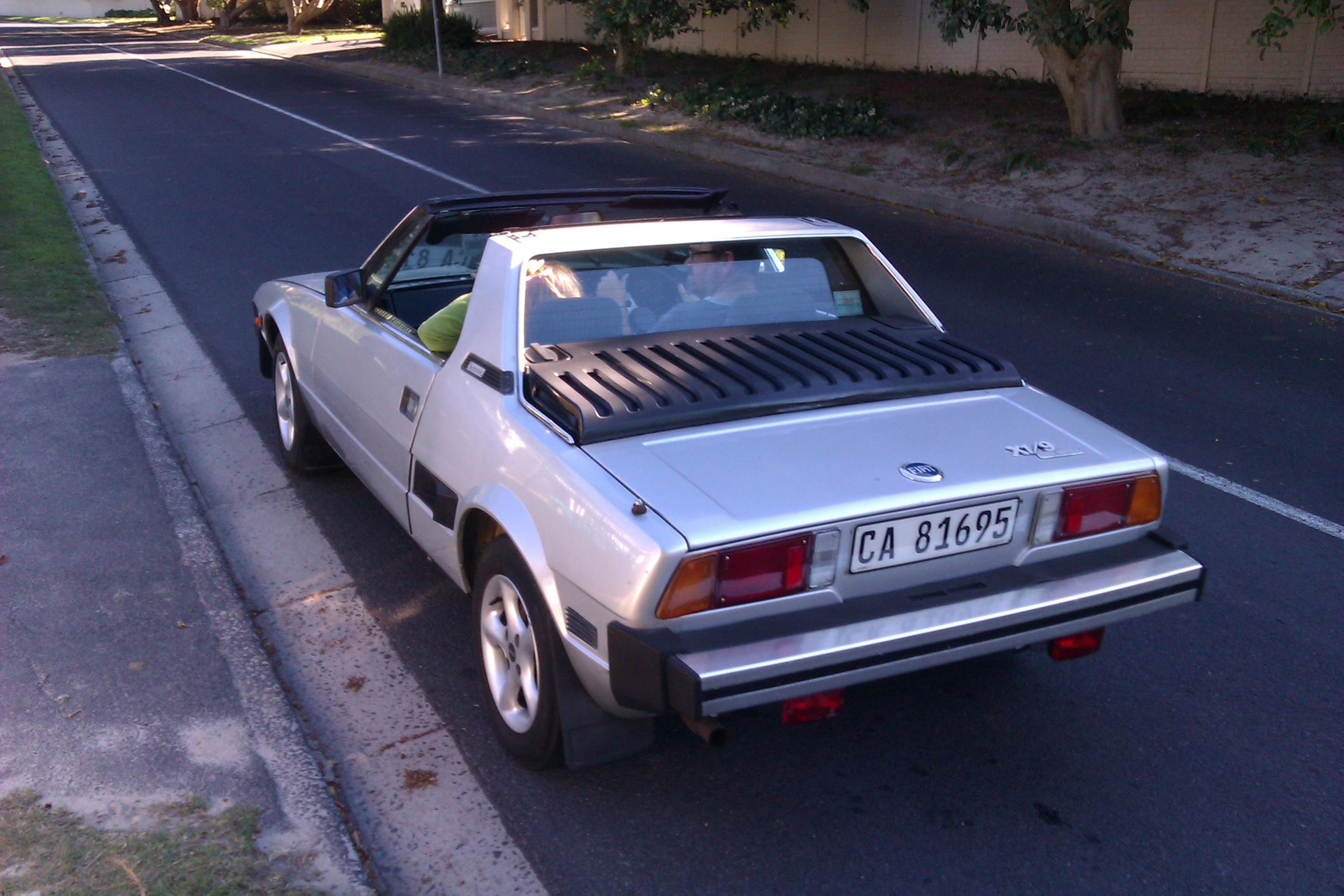

I always wanted one of these. I have a fondness for Fiats after having an Uno for 15 years.
I looked at several. None of them were drivable but this one had the least rust. The guy I bought it from was working on a 1932 Sunbeam. He was also even older than I am.
These photos were taken when I collected it. I was able to drive it home but only just. It would not rev over 2000 rpm and had almost no brakes. It was running so rich, If anyone behind us had lit a cigarette they would have gone up like napalm. We made it to my gate and then it cut out. So we rolled it down the driveway.
I stripped the carb and replaced the gaskets and needle valve. It had a home made gasket that prevented the floats from rising so the float level was always much too high. Part of the automatic choke, unfortunately made of unobtanium, is missing. It runs much better now but the carb still not right as it does not respond to tuning the idling mixture. The distributor (it has points and condensor) does not look great. The rotor ceramic is chipped and the cap is loose.
Bled the brakes all round but they are still soggy and front brakes hardly working at all. I suspect the master cylinder will have to come out. To do this I need to remove the dashboard and the steering column.
The motor sounds healthy but i suspect a problem with the clutch or gearbox or both. Very clunky.

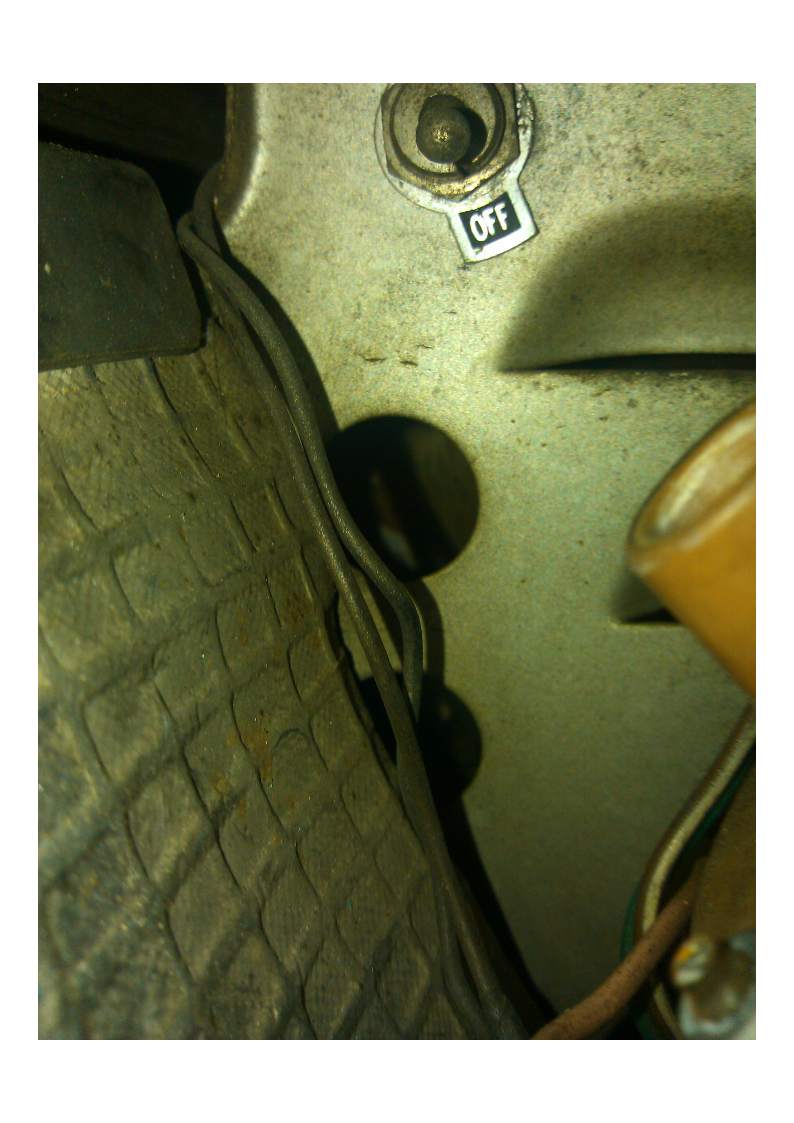

The wiring has been heavily worked on with lots of random wires of random colours going in random directions. Usually with dodgy random connections.
All in all great candidate for EFI. I have located at great expense and hardship (don't ask) an Uno Turbo manifold which looks like it should bolt straight in. And then either replace or upgrade the dizzy or go the triggerwheel route.

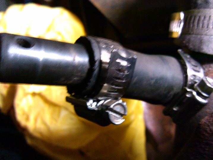

Here's another one, the cabin heater pipe is bypassed (the pipes under the car are rotten, remember this is a mid engine car). But it has simply been short circuited so that half the water is pumped in a small circle instead of going through the block. I pulled off the pipes and half the metal came with it because there is no coolant in the water.
And don't start me on the wiring. Lots of unfused custom connections direct from the battery.

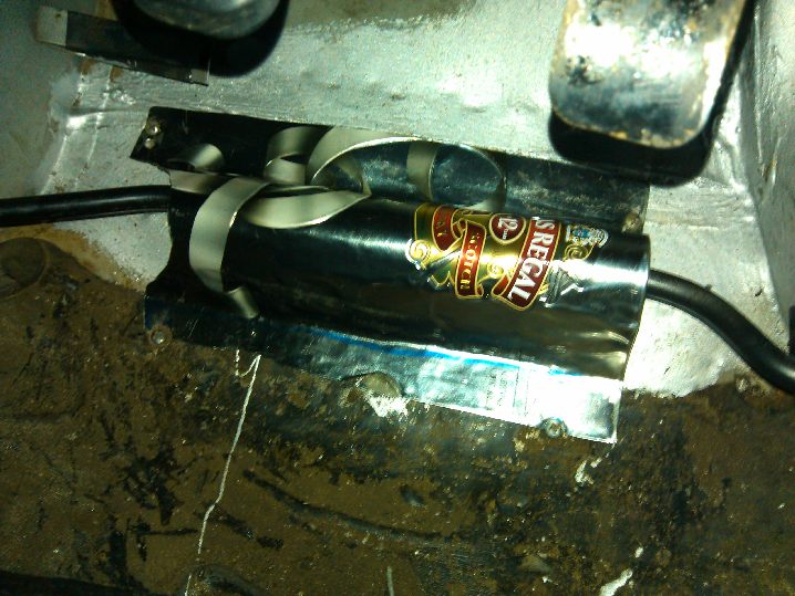

Take the accelerator cable. Its just a simple cable.
1) Wrongly routed though the firewall requiring a 120 degree turn to go to the throttle mechanism
2) Cable itself buggered as a result.
3) Wrongly routed speedometer cable fouled the pedal mechanism.
4) Pedal bar under carpet cover broken, leading to "toyota syndrome"
On a lighter note, I hope you like my replacement pedal bar cover. It was fun making it, especially emptying the bottle in the tin.

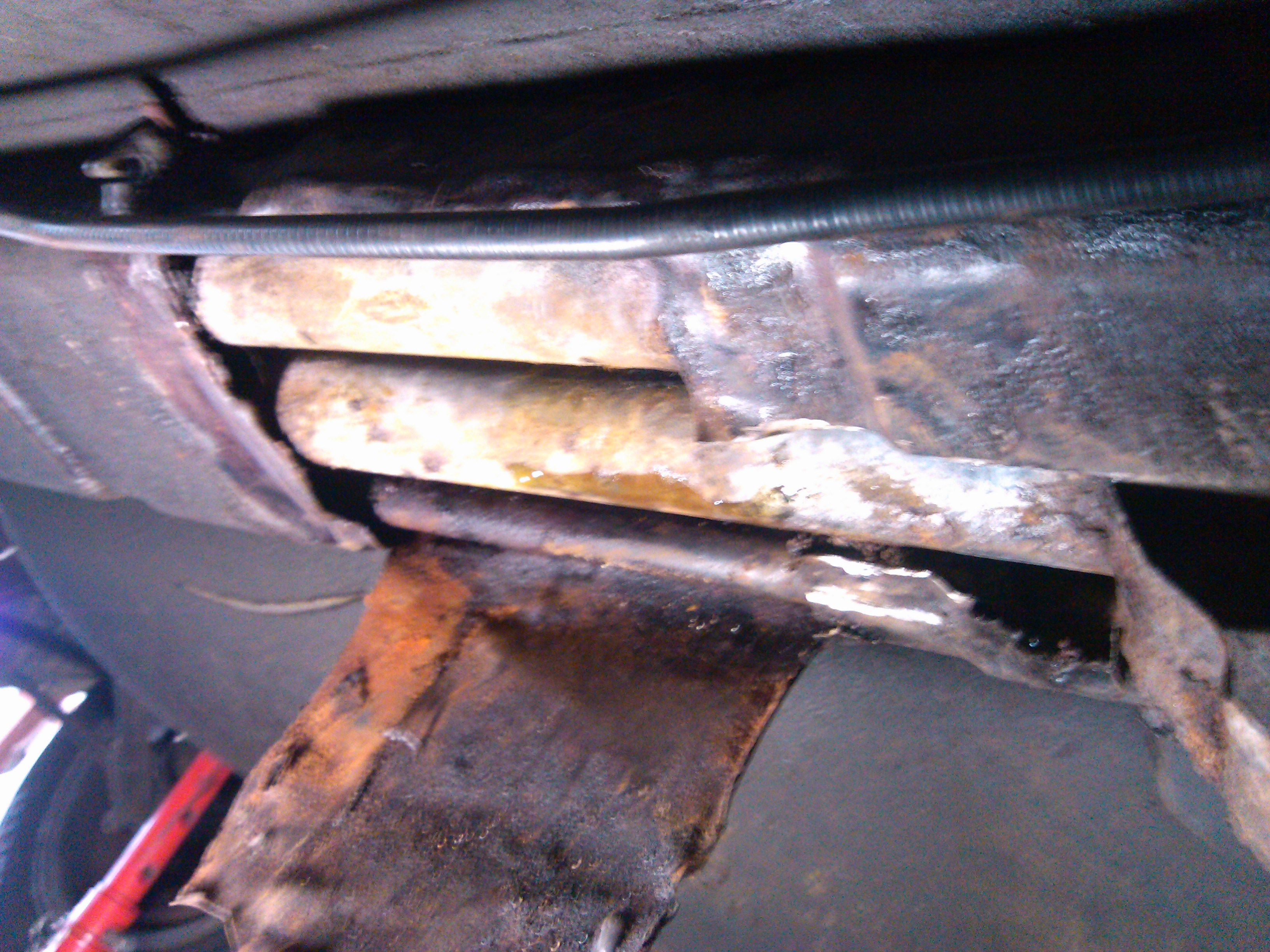

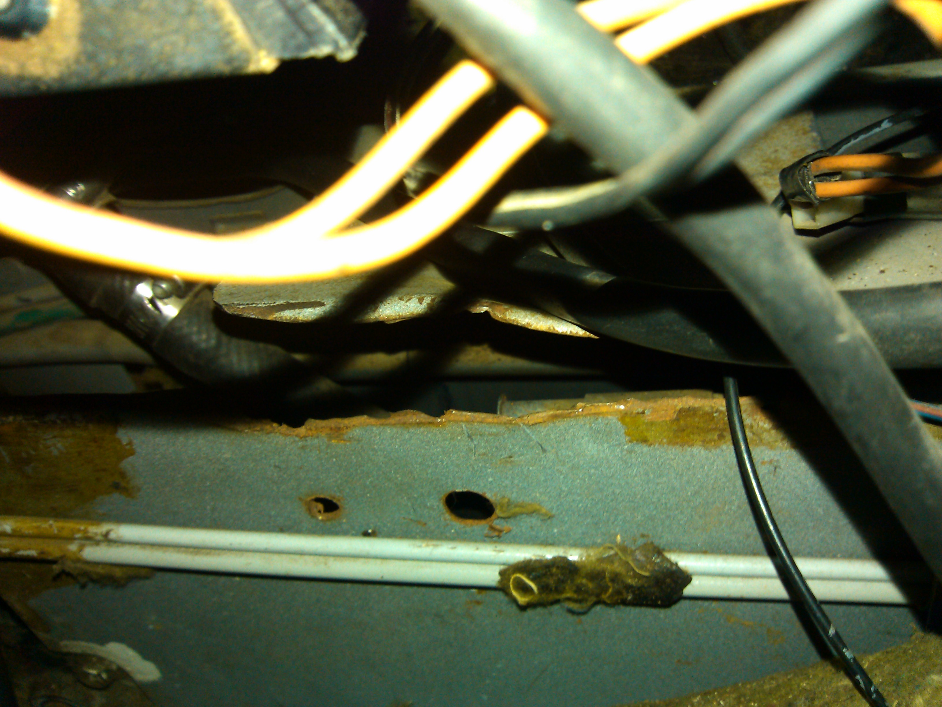

Biggest problem is the coolant pipes. I can see the belly pan has been cut open (looks like with a can opener) so I bent it back and peered into my worst nightmare. Its like one of those garden mist sprayers.
I'm pondering my options:
1. Sleeve the pipes with copper pipe (but what to do with the heater pipe?)
2 Remove the belly pan (I count about 100 spot welds to be drilled out)
3 Cut the belly pan off at the sides with an angle grinder seeing the car is used to this.
4 make up copper pipes to replace
5 OR get the pipes made up in stainless
6 make up new belly pan from sheetmetal.
I the meantime patch the pipes with radiator putty and hope it lasts long enough to get through roadworthy.

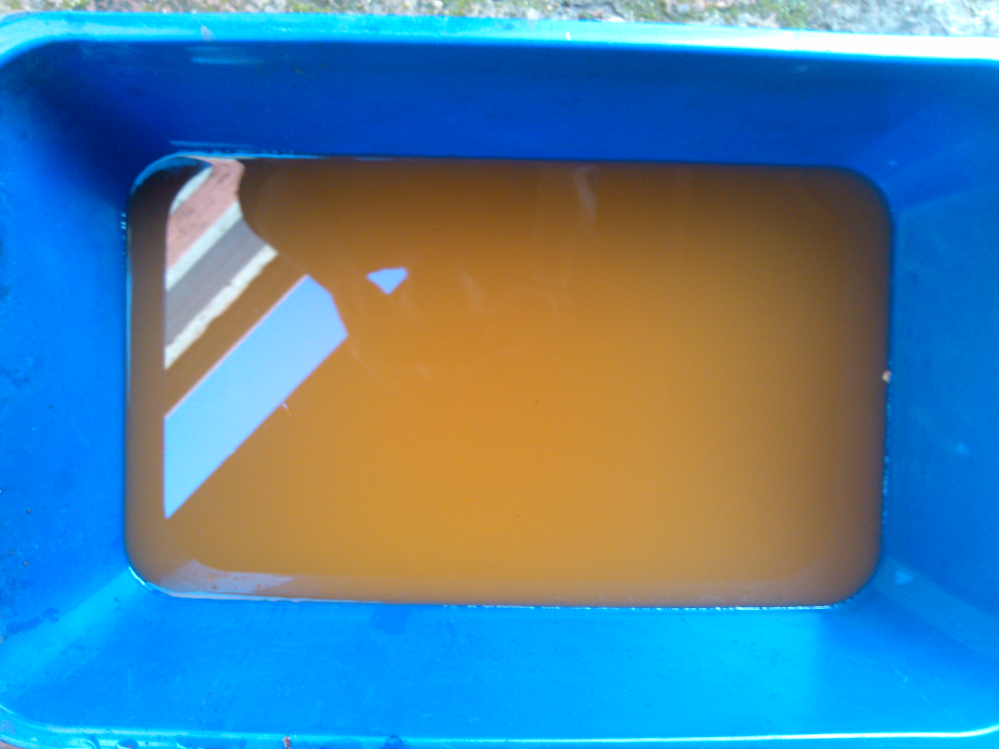

This is the was the colour of the coolant (just water really). Finally under the dashboard I found the PO had cut open the tunnel with an angle grinder. Can't figure out why, stuff is hard to get at, but not impossible. I cut my already buggered hands to shreds on this, This will need a complete cabin strip and welding.

One thought, copper pipes are soft, and will need to be well supported, as even copper can work harden and crack. It won't rust, though, but if you use zinc-alum pipe, neither will that on the outside, and on the inside it'll have coolant, and thus won't rust, either (provided you have no air in there).

Good point. The pipes have two 45 degree kinks at both ends so I need to find someone to bend it or buy a pipe bender. If copper, I could solder 45 degree joiners on. Zinc-ali will be much cheaper than stainless.

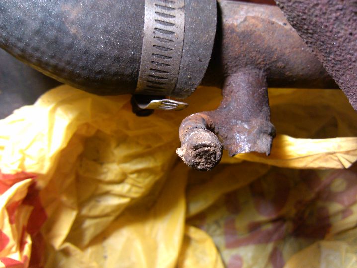

Clearly he had pipe corrosion before, the coolant heated choke is rusted off and one of the heater pipes has been replaced. The ends of the main pipes are rotten and bits of hose added on to lengthen them after the rotten bits fell off.
But he never thought, duh, there must be a reason for this, perhaps I should be using some additive, but noooo... he just chucks in more tap water. Probably pissed in it.

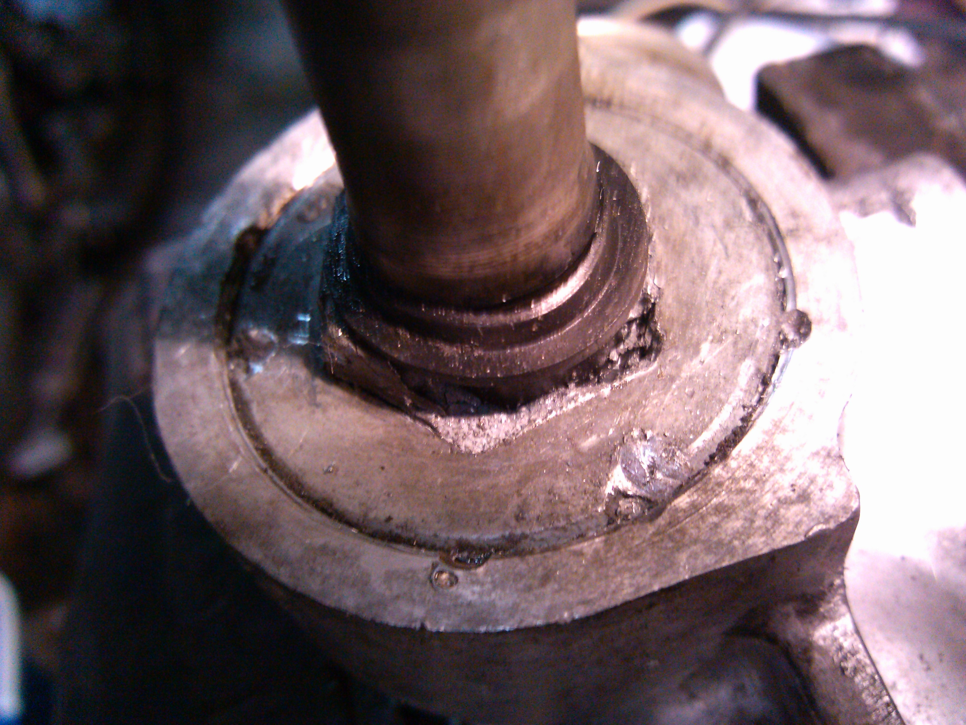

Removed steering box, found a bush was .. um .. just look at the picture Incredibly, found a replacement from the local Lancia man. Came with a delightful story about how this bush had been imported 10 years ago for the president of the Lancia club's son who never paid for it and and how they have been enemies ever since. So they were happy to get rid of it for a bargain.

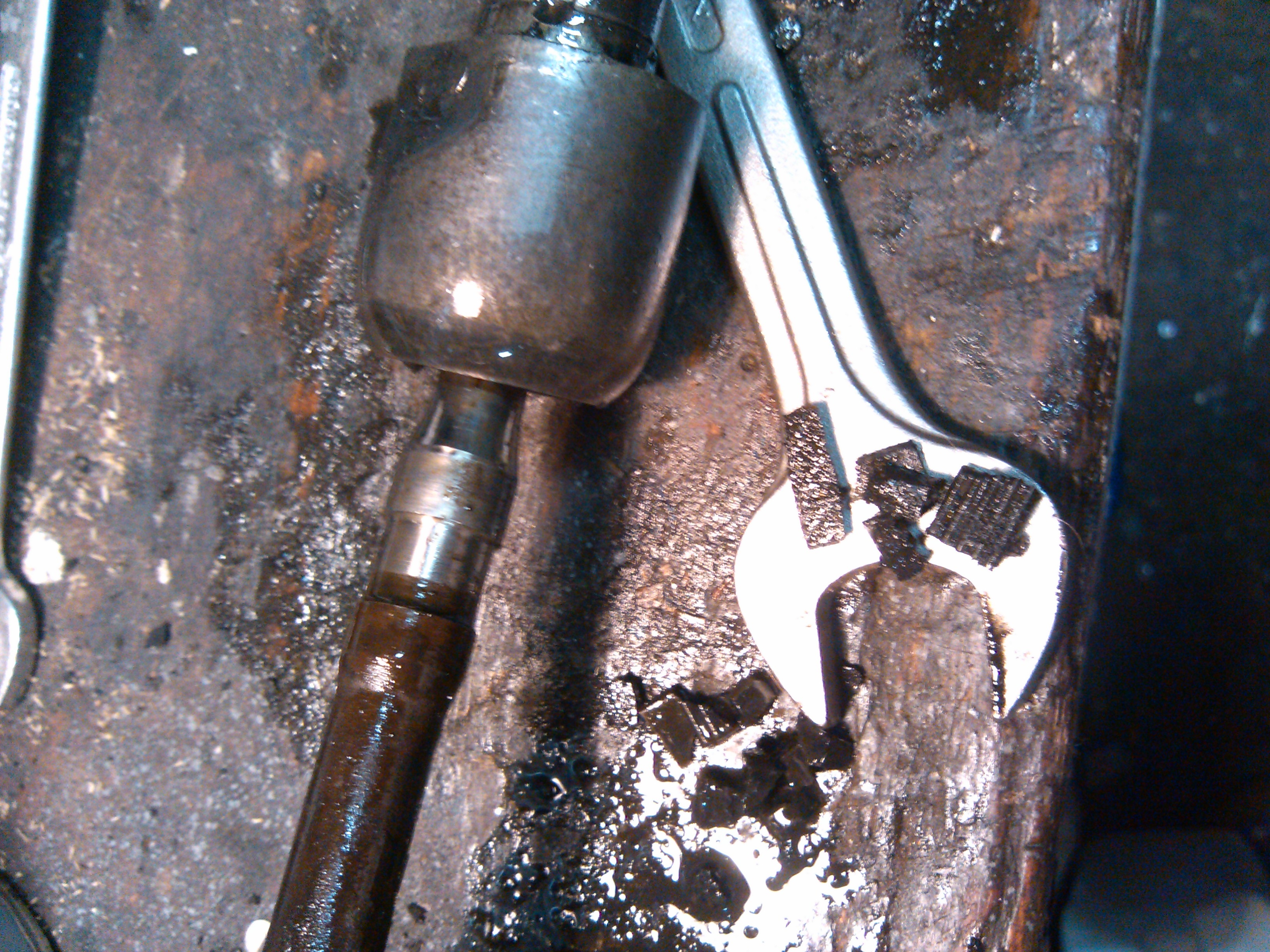

However this was just Murphy setting me up for a fall as the flanged nut on the pinion shattered during disassembly. Strangely happened after it had already loosened. Not sure what to do now so I've turned to booze.

Maybe drill two (or more) ~6mm holes into the face of it and make a special tool to turn it with X dowels that hang down into the holes, kinda like circlip pliers but stronger. If you don't need the nut part, this could be OK for the long haul? If you do need the nut part, use it to get it out and have an engineer make you a new one on a lathe. Or import/find one. It's cast! :-o wtf. Good luck! :-)
