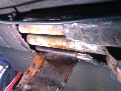

Here's another one, the cabin heater pipe is bypassed (the pipes under the car are rotten, remember this is a mid engine car). But it has simply been short circuited so that half the water is pumped in a small circle instead of going through the block. I pulled off the pipes and half the metal came with it because there is no coolant in the water.

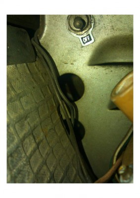

ooh! a hidden switch in the engine compartment. WTF does it do? Who cares? The wires fell off when I removed it.

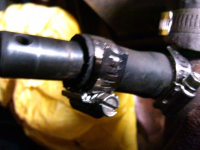

Some work with a dremel and the pipe can be blocked.

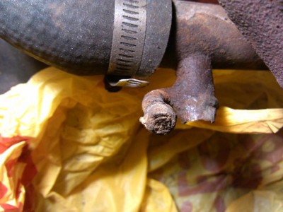

Some rotten pipework

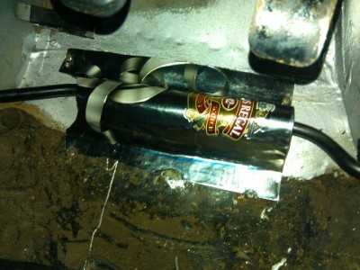

Take the accelerator cable. Its just a simple cable.
1) Wrongly routed though the firewall requiring a 120 degree turn to go to the throttle mechanism
2) Cable itself buggered as a result.
3) Wrongly routed speedometer cable fouled the pedal mechanism.
4) Pedal bar under carpet cover broken, leading to "toyota syndrome"
On a lighter note, I hope you like my replacement pedal bar cover. It was fun making it, especially emptying the bottle in the tin.

Biggest problem is the coolant pipes. I can see the belly pan has been cut open (looks like with a can opener) so I bent it back and peered into my worst nightmare. Its like one of those garden mist sprayers.

I the meantime patch the pipes with radiator putty and hope it lasts long enough to get through roadworthy.

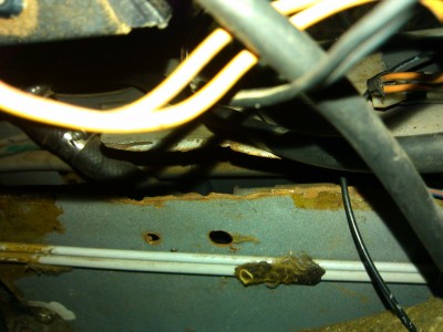

Finally under the dashboard I found the PO had cut open the tunnel with an angle grinder. Can't figure out why, stuff is hard to get at, but not impossible. I cut my already buggered hands to shreds on this, This will need a complete cabin strip and welding.

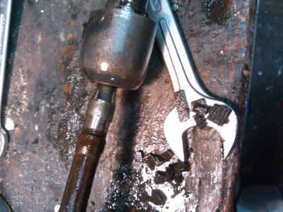

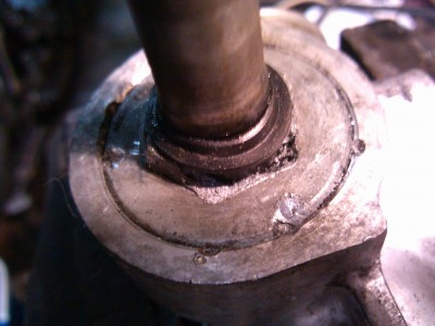

However this was just Murphy setting me up for a fall as the flanged nut on the pinion shattered during disassembly. Strangely happened after it had already loosened. Not sure what to do now so I've turned to booze.
damn! damn! damn!!!
damn! damn! damn!!!
Re: Neil's Fiat/Bertone X1/9
Maybe drill two (or more) ~6mm holes into the face of it and make a special tool to turn it with X dowels that hang down into the holes, kinda like circlip pliers but stronger. If you don't need the nut part, this could be OK for the long haul? If you do need the nut part, use it to get it out and have an engineer make you a new one on a lathe. Or import/find one. It's cast! :-o wtf. Good luck! :-)
