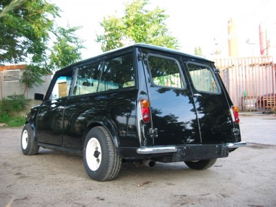

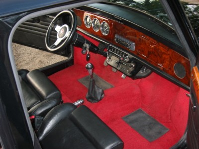

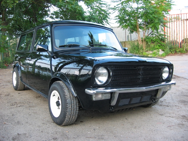

Due to recent demands, I present one of my rides that's in desperate need for an EFI system.
It's a Mini Clubman Estate with 1300cc A+ Series engine, fitted with a HIF44 carb.
The pictures are from when I bought it over eBay, without having looked at it. It was just *the* car I was wishing for back in 2004. Fortunately the car was in the shape the pictures were promising.

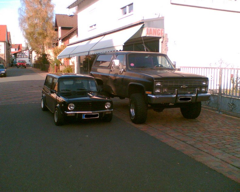

Some more pictures... It wasn't my fault, the other guys insurance paid all damage.
Edit: Oh! Now, looking at the post.. No, it wasn't the chevy that squished the mini :) In fact it was a Honda Civic.
I just liked the picture so I posted it too ;)
