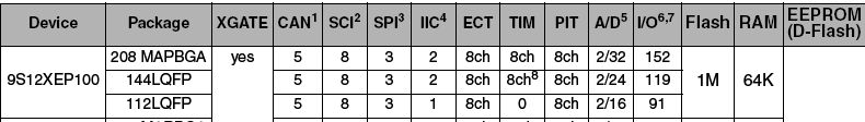

Above is from the XEP product brief. The 112 pin part misses out on 8 timers!

That is just the pin out stuff, the peripherals are still present internally. IE, someone with a low pin count chip can only use N IO ports, but the software will remain the same for the higher pin count variants. Any bit banged timers will still continue to work the same regardless of pin out or not.ca7 wrote: Above is from the XEP product brief. The 112 pin part misses out on 8 timers!
The main point being that the TA board is a minimal part in either the DP or the EP case. You can pick up a bunch of ADC channels on the DP on higher pin count packages. Same goes on EP but with timers too. IE, if someone builds a board using the 204 pin chip, they can have it all mint as you like.
