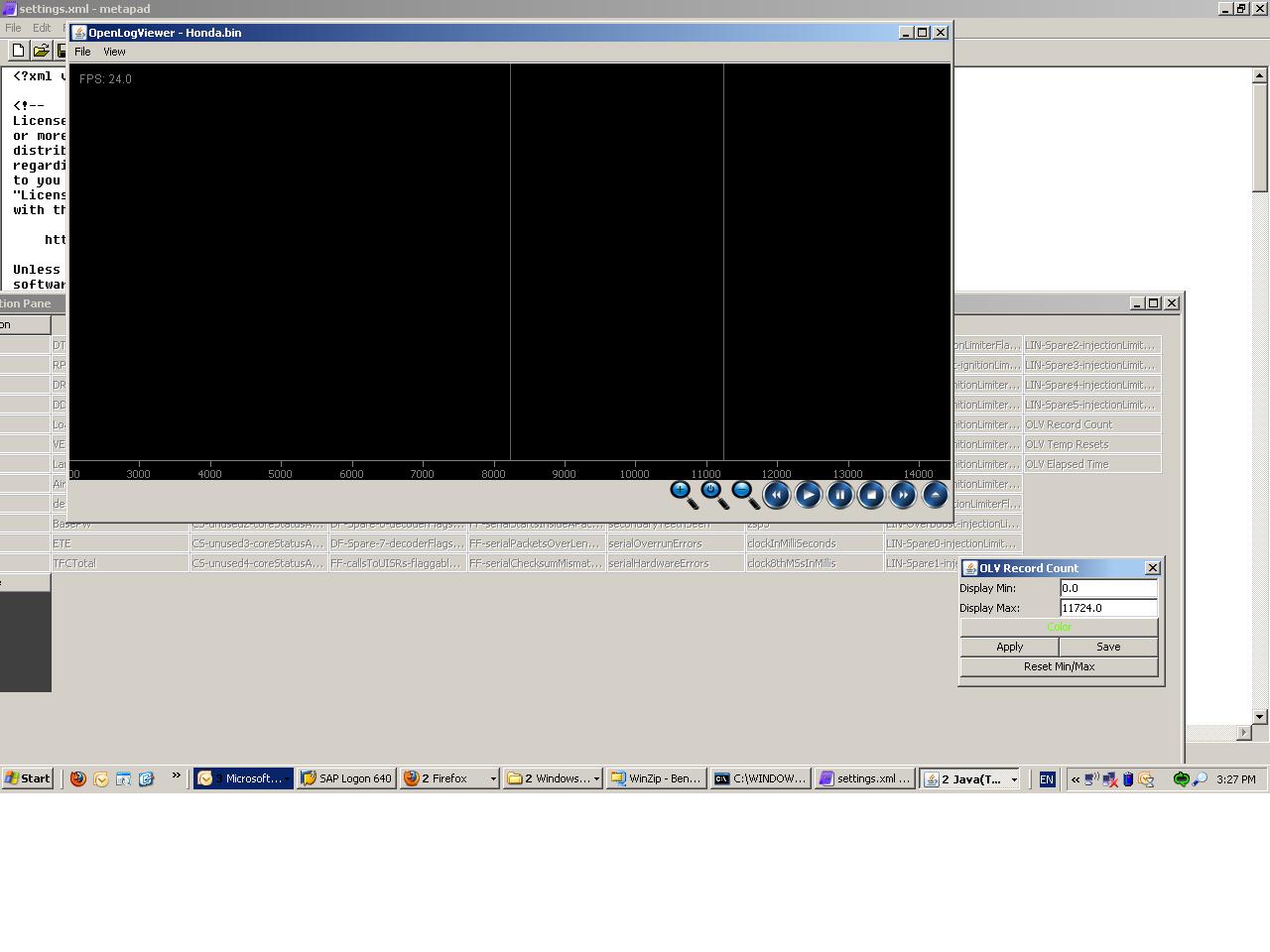

OLV log files not displayed correctly in Win32.
My setup in office computer:
WinXP 32 bit with JDK1.7 & maven3
OLV plugin is latest from Ben's GIT with POM fixed 11 days ago
Installation and compile of OLV is smooth without error.
Only one issue is I use mirror on repo1 server (it seems repo server is dead)
All bin, csv files can be loaded correctly. The log is able to run and stop.
But there is no log graphics on display. (or the graph displayed in black color only)
I have changed the color pane and setup. There is still no trace graphic at all.

Re: Recognising An OLV Crash - Please Report These
Hey Kenny,
That's probably not a bug, your data is probably corrupt. Take the data file and run it through the freeemsParser.c file (after compiling it) and compare the output, it will match OLV almost exactly.
How have you recorded this data? You need to use a reliable program with the correct settings or you'll just record garbage.
Post by Kennybug »
fred, thanks. will try to run the C program.
I still not get any running engine
My log is from pete:
viewtopic.php?f=62&t=1533&hilit=maven&start=20
I have try another csv file from hot cat, it was a clean csv table. it also not working.
viewtopic.php?f=32&t=1604&p=24413
I think it may due to the latest jdk 1.7.0_u04
will get OLV run on debian & OS X tonite for double check :P
Try this one: http://stuff.fredcooke.com/forMal.bin
The firmware and OLV versions have to match or it will just reject them. Look at your console for info. The above linked file should work with the latest OLV from all three repos. The hash is: c43d3f8e796e8a4e80c42668ce51c380eac473fd
