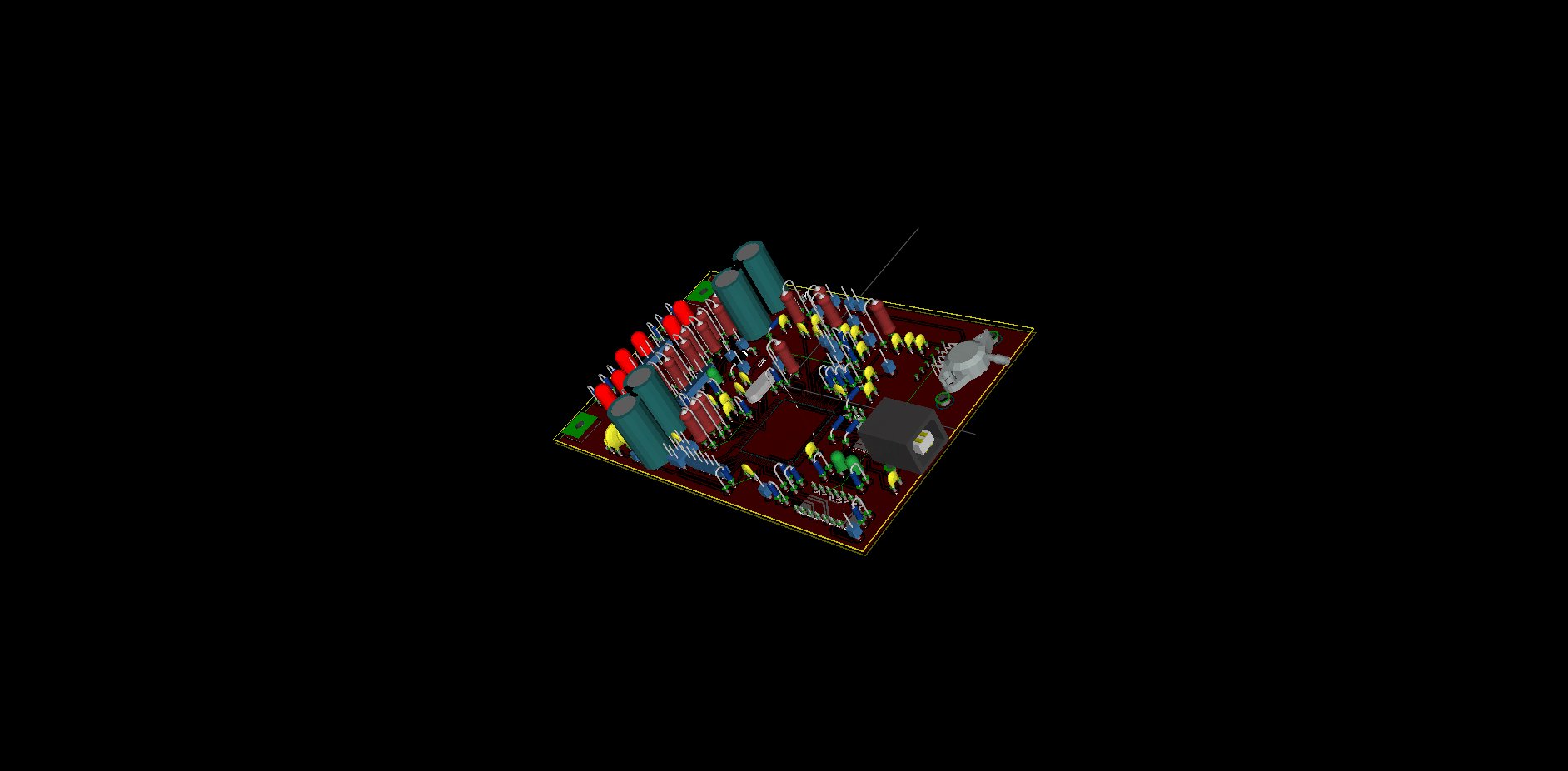

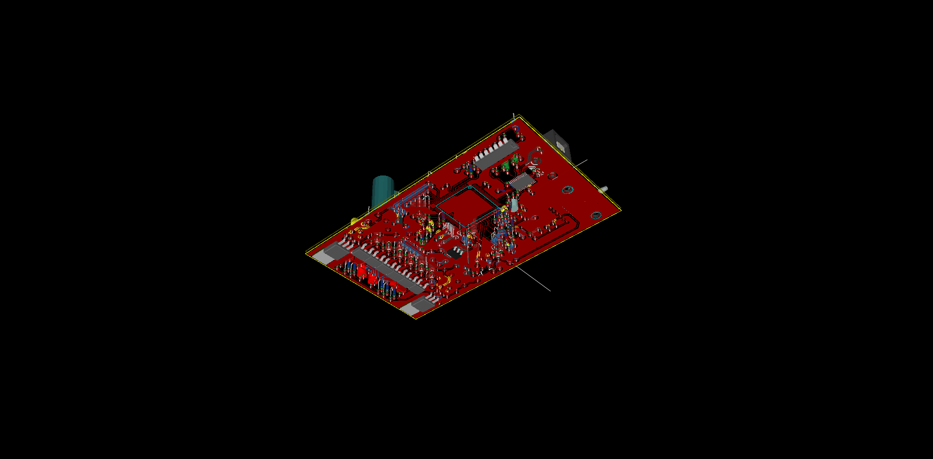

Here are a few teaser pics of the board from KiCAD.

Some sad news! Check the injector and ignition pages of RavAGE, you're going to be doing some jumpering to get things working, or, running very very alpha code by Sean. Though if you do that, you do not have my support, only his, for everything, not just that code, sorry, but that's the way it has to be for the time being. Right now we have only 6 outputs. T2-7, shared between ign and fueling. it shouldn't be too painful, hopefully to run resistor feeds from them to your injector drives. Fingers crossed. This is why I ask everyone who is running/designing/doing anything real to keep in close contact with me. In any case, Sean will be happy to have a tester, hopefully he's got what it takes to support the rest of your install/setup, software, wiring and config wise too.
Looks cool! :-) What are the four huge electro looking things? Hopefully not four huge electros :-) Putting huge capacitance on the board is a bad idea as it drags current across the ground during voltage fluctuations in the vehicle. 50uF max is likely a good choice, 10uF min, same before and after each reg.
Will have to review more later, gotta get up eat and drive somewhere without being deported today.

I had planned on 1000uF for the four electro's since that is what I saw in the DFH and Puma power supply circuits, but I will change them to 47uF.
