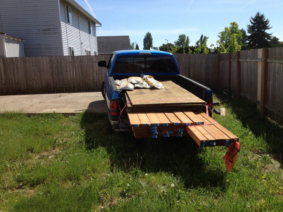

my other vehicle is a '99 dodge ram quad cab 1500. 20 feet long with a minimal computer and a 5.7L. Has SLT and just got in its second accident. My wife hit a bush going 65 on bad traction. I bought really good tires for it so it must've been bad. That's why my insurance deductible is low and my cars are well insured.
