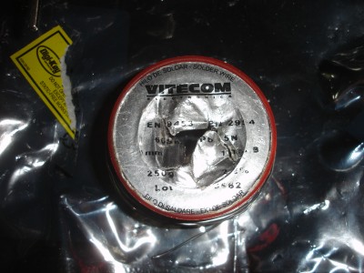

The solder is.
The label is ripped off, but this is what I can make of it:
EN 9453 EN 2954
60Sn4??Pb 5N
1mm 1.1.3 B
250g 2.2%
Lol 2562
No idea what the above means.
Also I got the hang of it, if it preheat the part with the soldering iron 2 or 3 seconds then aplly the solder i can get a nice hot solder.
I ended up resoldering those connections specially the injector grounds, they look a lot better now.
Thank you for the input.

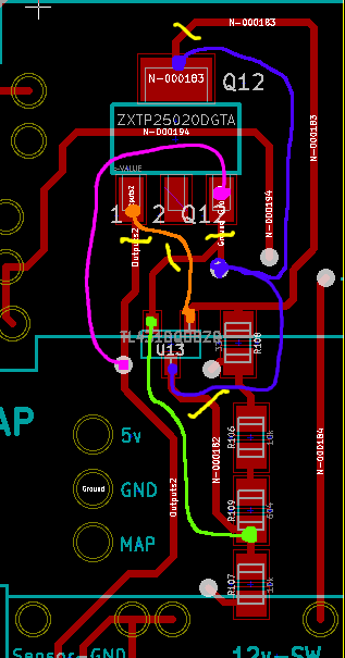

So a few weeks back while trying to solder some connections my uglyx overtage fix desoldered as long with some components.
Here is a log on #freeems-ot of head burrial ceremony:
PS saved for later editing271394 2014-04-06 15:46:37 masterkorp download/file.php?id=1436&mode=view
271395 2014-04-06 15:46:53 masterkorp damm those things are so small i can't even identify them
271396 2014-04-06 15:47:03 masterkorp DeuceEFI: around ?
271397 2014-04-06 15:47:20 @DeuceEFI hello masterkorp
271398 2014-04-06 15:48:21 masterkorp are those R106, R109 the same ?
271399 2014-04-06 15:48:30 masterkorp and R108 ?
271400 2014-04-06 15:50:11 @DeuceEFI R106 and R107 are 10K ohm, R108 is 330 ohm, R109 is 604 ohm
271401 2014-04-06 15:50:29 masterkorp are the resistors ?
271402 2014-04-06 15:50:32 masterkorp *they
271403 2014-04-06 15:50:39 @DeuceEFI yes, they are resistors
271404 2014-04-06 15:51:09 @DeuceEFI R106, R107 and R109 create a voltage divider circuit
271405 2014-04-06 15:51:26 @DeuceEFI R108 is a current limiting resistor
271406 2014-04-06 15:52:02 masterkorp they so small i can't solder them
271407 2014-04-06 15:52:14 masterkorp *they're
271408 2014-04-06 15:52:29 masterkorp can i get regular resistors and solder them there ?
271409 2014-04-06 15:54:48 @DeuceEFI you could, just make sure that R106, R107 and R109 are 0.1% resistors as the resistance is critical for setting up the voltage divider
271410 2014-04-06 15:55:01 @DeuceEFI 0.1% tolerance
271411 2014-04-06 15:55:43 masterkorp thanks. i will try to solder them, if i can do a decent circuit i will fallback to that
271412 2014-04-06 16:00:10 masterkorp and U13 ?
271413 2014-04-06 16:00:18 masterkorp i think i broke the connectors on it
271414 2014-04-06 16:01:36 masterkorp yeah i broke
271415 2014-04-06 16:01:37 masterkorp dammi
271416 2014-04-06 16:03:56 @DeuceEFI here is the TI information on U13, they do have larger versions: http://www.ti.com/product/tl431b
271417 2014-04-06 16:04:03 @diyefi-bot Voltage Reference - Shunt Voltage Reference - TL431B - TI.com
271418 2014-04-06 16:04:37 masterkorp thanks !
271419 2014-04-06 16:04:46 @DeuceEFI you're welcome
