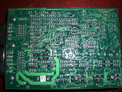

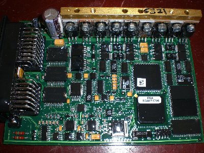

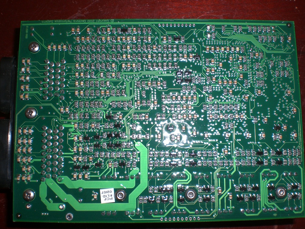

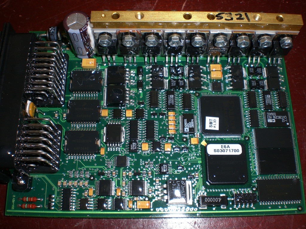

I took some pics of the motec M400 board this morning and a few part numbers along with it..
a quick run down of it is
Outputs
* 4 x Injector outputs—high or low ohm
* 4 x Ignition outputs
* 8 x Auxiliary outputs—for functions such as camshaft control, drive by wire throttle, boost control, nitrous injection,
idle speed stepper motor and many more
Inputs
* 8 x Analogue voltage inputs—fully configurable including custom calibrations
* 6 x Analogue temperature inputs—fully configurable including custom calibrations
* 1 x Wideband Lambda input—for Lambda measurement and control
* 4 x Digital/speed inputs—for wheel speeds and function activation
The board has 3 things you notice right away.
1, the 18 TO220 devices on the board.
2, the fact that there are 3 MC33385DH low side drivers on the board.
3, what seems to be an insane amount of flash.
Now i am by no means saying we copy this ecu, but if you are building a car there is no sense in reinventing the tiers for it..
The motec ecu is one of the best, so we can take some ideas from them i do not see any harm in that, most of the components are commonly available anyway..
8 of the TO220's are IRFZ34N's, these seem to be fuel and ignition, these seem to be GPO's
2 are LM2937ET 8 volt regulators.
8 DPAC transistors are IRF647N's
the rest i cant see what they are as there is an epoxy coating on everything.
I like the sound of the low side drivers though.. These seem to be what give the Motec the ability to do diagnostics on there fuel and ignition channels.
http://www.datasheetcatalog.com/datashe ... 85DH.shtml
now a pic or 2
