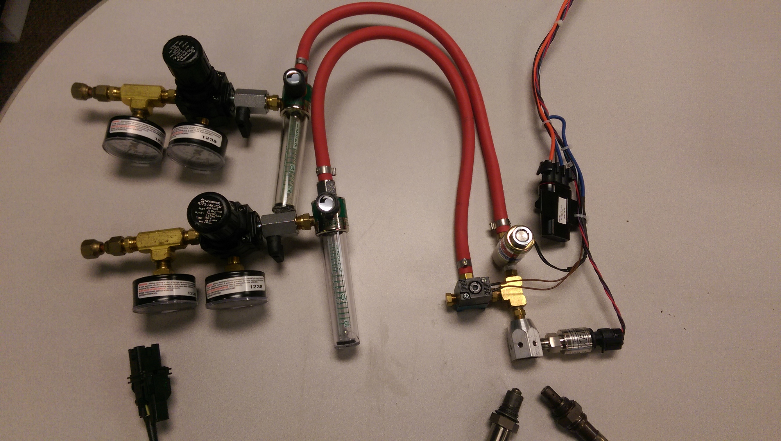

bmotorsports wrote: I'm interested in what your test rig looks like, care to share?
The goal for this tester was to try to come up with some method of getting repeatable system response measurements. I had built a few before but they were overly complicated and really just a PITA to work with. My latest version is a desktop setup that is almost fully automated and seems to give extremely repeatable results.
The basic design is two gas bottles (call them A & B) and the mechanism to quickly switch from one to the other, as closely to a step function as possible. And monitor the output to see how fast the sensor output reaches the new value.
Test gas A is flowed steady "on" at about 2 L/min through a solenoid. A signal is sent to Solenoid A to switch it off and to Solenoid B to turn it on. Solenoid B is a high current Nitrous solenoid with a solid state driver to minimize on time delay. The A gas stops flowing and the B gas starts flowing (also at 2L/min).
Both gasses are at room temperature and have the same flow so there should not be any thermal shock associated with the switchover.
The volume of gas after the solenoid and before the sensor itself has been minimized to pretty much as little as possible.
There is a pressure sensor screwed into the O2 sensor holder as well as exhaust ports for the test gas that has passed by the O2 sensor.
The solenoid trigger line, the pressure sensor output and the O2 sensor controller output is logged at either 500hz when I am just screwing around or 10Khz if we are collecting for real.
In early testing, the two gasses were run at slightly different flow rates to allow the pressure sensor to try to detect the arrival of the pressure wave from the second gas. Doing this netted a measured difference between the signal being sent to the solenoid and the pressure changing of between 8ms and 11ms, time and again. But when the gasses were flowing at the same rate this was not measurable. This time was the arrival time for the pressure wave, which should theoretically be faster or arrive earlier than the test gas itself so it should be considered a conservative estimate only. Ultimately, we decided to ignore this number since it could not be measured during the actual A/B testing with the same flow rate so just keep that number in mind and remember that about 10mS is spent just physically switching the solenoid and replacing the gas volume with the new gas.
We got the flowmeters from McMaster and the majority of the fittings at the same gas company we got the test gasses at.
For control I used an ECU I had and set up a program in it like an industrial controller. It would just flow gas A for a couple seconds to stabilize then do a series of A=>B, B=>A, A=>B step tests, 10 each direction. So each test generated about 30 seconds of data.
I determined the lambda value the controller stabilized on for each gas and normalized the results to those numbers. Then I used the T63 time (the time it takes the value to change to 63% of the new value) to determine the response time.
There is also a T90 time but many of the controllers could not hold their final reading to stay within the T90 threshold value so it could not be used.
We used a full size car battery inline with a 20A power supply to try to get the cleanest possible analog signal out of the devices and followed the mfg instructions but many still had incredibly noisy signals.
The test would be better if we could have heated test gas (say 500C) but that's not going to happen on my desktop.

where is the gas going after it hits the o2? Is it venting to atmo though the holes that the o2 sensor is connected to?
