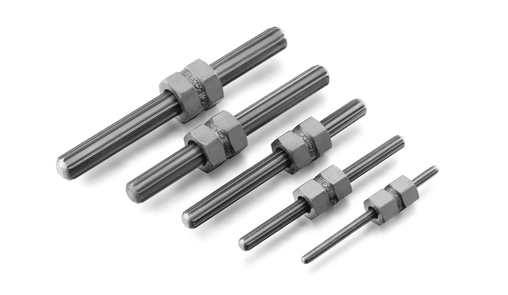

Photo of those things for reference:
Sat Jul 30, 2016 11:47 am
Joined: Fri Sep 16, 2011 8:37 pm
Posts: 147
Location: New Zealand
I've had the most luck with the straight variety.
The parallel/non-tapered ones seem to work the best but you need to drill the hole well for the size of the minor diameter.
Sat Jul 30, 2016 12:13 pm
Posts: 15344
Great stuff! I'd never even heard of or seen those types! Keen to own in future, though! :-D
