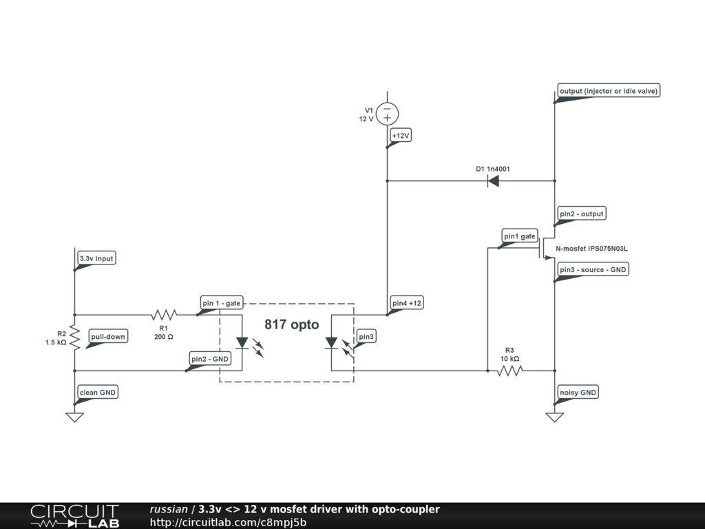

To begin, at first I was trying to control only fuel or only ignition (with stock ECU controlling the other piece of the puzzle), but soon enough I've realized that I should also control the idle air valve. Crank signal and MAF voltage are currently my only two inputs and I've extracted the fuel map from the stock ECU.
So, currently I control fuel injection and idle. Stock ECU does ignition. This thing starts and I can set idle RPM programmatically.There is still a bug somewhere because things are not super smooth if I push the throttle pedal rapidly, but still
