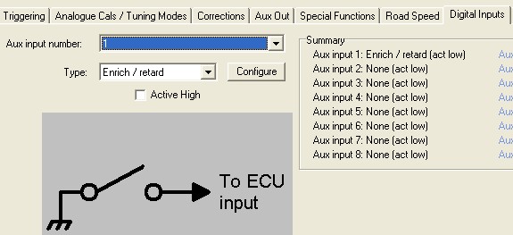

Except for MS, the only other ECU I've used is an e420c from Adaptronic.
The configuration software for the e420c ECU is called WARI. You can get a copy to play with, from the web site.

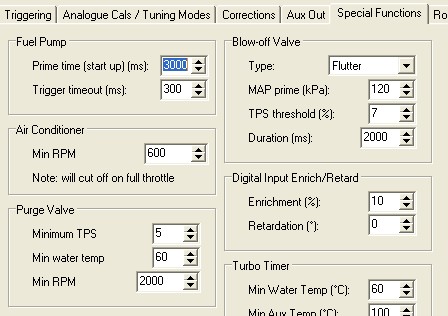

When you select a standard type like "Fuel Pump" the configure button becomes available.
Pressing "Configure" takes you to the "Special function" page where you can configure these standard functions.
Selecting Inputs is similar the the Aux Out selection. First choose the input number than select the type. Standard types such as the Enrich/retard function are also configured on the "Special function" page, as shown above.
CA
For outputs you first selected the output number. The text in the pull down list tells you the current limit and if they are PWM capable.
That looks awesome! Of course, you'd STILL need the pin definition page because the hardware is specific to the build. Hopefully the software is broadly applicable. We don't have control over the hardware. So you could use that, but you HAVE to tell it somewhere what you have. For instance, MY inputs will likely be a different format than most people's VR inputs as I have a circuit I like. I might also put (as an example) a giant 20 amp relay on it, or a 10 kv power supply for a display. Just silly stuff to show you might customize that.
I do like the summary list! I imagine some 2-D windows/graphs as in MS. That would work for variable fan speeds or any non-PID control.
I'm not as sure I like the "Configure" tab as it is very limiting! You can only do what they have there - i.e. one output for fuel pump, etc etc. A generic handler would cover a LOT more people. Say you have 16 sequentially opperated fuel pumps. Mine would work great - just define those pins' names, then say "16 outputs", set the values and you're done. It works.
If it can be virtualized/programmed by you shiny happy people, I'd be honored to use it. :-)
