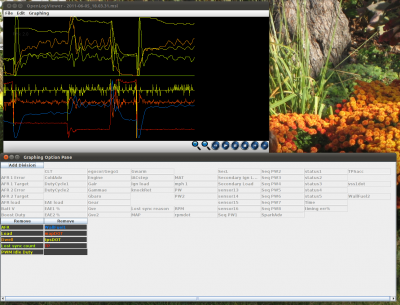

Ok, If I install the huge package that is maven2, I can get it to run. Would like to know how to run it without all 200M of Maven2...
Who is developing this, currently?
It would be nice if it had values on the axes (X and Y) and a legend so that the individual traces could be followed. Also a bit more intuitive as to how to change the color of a trace.

Gearhead, because you're running a development version, you're using development tools. Maven3 (2 worked? cool, but you should be using 3...) is THE dev tool for Java stuff, ant used to work, gufi broke it. It was an autogenerated build script anyway, and the last generation was not a functional one.
Gufi and I are working on this, intermittently. He put in some UI commits last night, I've not tried them yet, could be good, could be bad.
