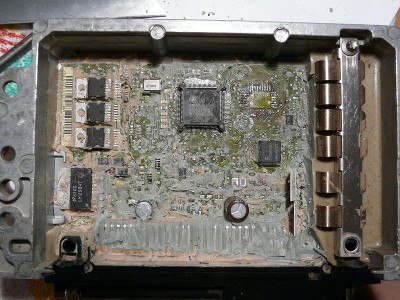

As i know there are already good solutions for Power Supply.
I got a LM2984T on my OEM ECU pcb, i think it is very exotic but there should be similar solutions
Picture is stolen somewhere from the internet :lol:
