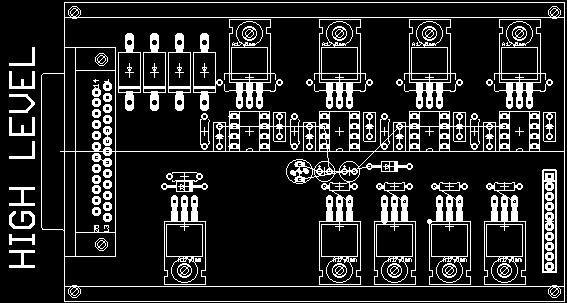

I am of the opinion that a basic output board is a start (mostly because that's what I started drawing!). The one I started with is a basic 2-layer board with four peak&hold injector drivers based on the NS LM1949 chip, and four spots for ignition IGBTs. There's enough room to add probably two darlington transistors (TIP122s, or similar), but then I'm guilty of feature creep too! Arrrgh! It's got a DB25 for output, and a sip connector to link it to some other board. I made it fit a 3" slot width LMB case, but I also added holes in all four corners to allow mounting the board to a plywood or cardboard base (I had you in mind Fred!). Nothing fancy, but just a way to provide a reliable basic set of output circuits that won't be problematic during firmware development...
Next would be another basic card with some input signal conditioning, and a saddle for the TA card, or a separate saddle board for the TA card...
Abe, I like your mention that the expected lifespan is only about 3 months - you must write code pretty damn fast!
To me, the mention that Fred won't define pins is symptomatic of the lack of any basic hardware to start development around. I think any particular CPU pin assignments should be treated as prima facie (considered right until proven wrong in the future) until development has a chance to get a bit further along. If the TA board plugs into some saddle board that allows solder-able jumpers to electrically reroute pins as necessary with discoveries in coding, then we can give the coders the ability to rewire things as necessary until the pin assignments can become more firm. So far, if you ask Fred to define the pin usages, what is he going to base the assignments upon? He simply can't do it yet because he hasn't made any incorrect assignments yet to know what is right and what is wrong. What he will need is a short-term hardware platform to allow pin reassignments as an intermediate, until he can decide what makes sense, at which point we get our holy grail - sensible and meaningful pin assignments! Woot woot!
I'm rambling, but you get the idea. Here's what I started with so far... (and certainly tell me what you think)
Re: We need to lay out a basic board
Great posts guys! I'm sorry I haven't had time to reply properly :-( Just been too busy and too deprived of internet to post/PM in any meaningful way.
I really like the modular ideas you are laying in front of us, 510rob. I just didn't want someone finalising a board design, getting a bulk buy happening only to have me switch the major core pins around within days or weeks - this could alienate people. I'm happy to use any random pins short term, but medium term, before we go widely public, I want it to be pretty stable and totally correct/optimal.

As you can see in Fred's first controller, the circuits we need, are quite simple, and fairly easy to build, even by hand, with out etched boards. The etched boards are intended to allow some extra robust features like EMI and ESD protections, as well as creating a common platform, such that you can have an idea about what might be a source of a problem. The board I've titled FreeEMS 1.0, is a bare min IO board, specifically designed to work with the TA card, but other brains could be added if so desired.
BatchPCB.com makes boards for $2.5 per sqin, so the 1.0 board could cost $70, in qty 1. If we play to some other specials, I'm sure we can get that price down under $50. I don't see this as cost prohibitive, most any of us doing dev could spring for that.
About a DB connector that connects to the JimStim, I'm all for it. As you say, modular design is very handy for prototype purposes. Most of us agree, and we have specified our boundaries of modular design as a stack, the TA brain, FreeEMS 1.0, and the connector card.
Seems we drew slightly different boundaries from what you drew up. Ours has been extensively discussed and I think we are on a good path with it. I'd certainly enjoy hearing your input on this design. Or even better, perhaps I can encourage you to make a connector card with KICAD.
A connector card could be made by starting with the layout I'd drafted up, delete the stuff you don't need, but leave what you need like via's, ect, then add the DB connector, perhaps another OEM connector if you so feel inclined. I haven't done this yet, because my project uses a harness, and I have no need for such a connector. All my wire lengths are going to be less than 3ft (1m) long, I only have 1 cyl, so I can go straight to the board.
In the future other features can be added by adding to that stack. So we are planning for the future feature creep.

If we break it down into 'boards', I see a need for one being an input/power supply. This would have 6 a2d and 2 optos and/or 2 LM1815. Another board needs to be the outputs. The only high level that need to be on the dev boards are injector driver (6) FETs (and as we have discussed elsewhere, these should be buffered with FET drivers). The rest should be low level (2n2222 or bs170 or some multi pin buffer chip with similar current capability - CA3262). I think the minimum quantity should be 8 *and* these would be easily used as input or outputs with jumpers. When we add igniton, these should be done off board anyway due to noise and power considerations... An integrated solution would be developed after this initial dev work.
I agree that the cost for am etched board is not high. If we do a group buy on these, we have the potential for more people actually helping with the development. There are more people willing and able to solder a board than there are those that are going to drive on a breadboard with loose wires. I know I am more willing to do this on an etched board than what Fred was driving on (no offense). This said, If we are going to the effort of laying out a board, why not a single and why not put the micro on the board? If it is 50.00 for a board then 100.00 for a TA chip, why not 50.00 for the board and 12.00 for the freescale chip? If we are willing to wait a little bit (more than 2 weeks) we can even get HK or TW proto manufacture for cheaper than what Jharvey mentions *and* we can have them solder the micro and the associated SMD stuff we need (caps) at the same time!
