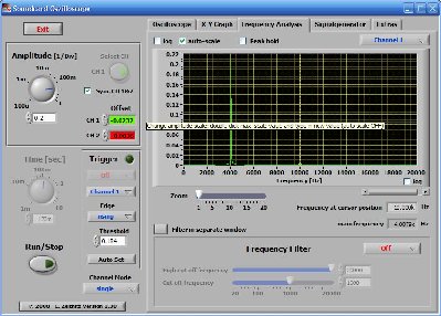

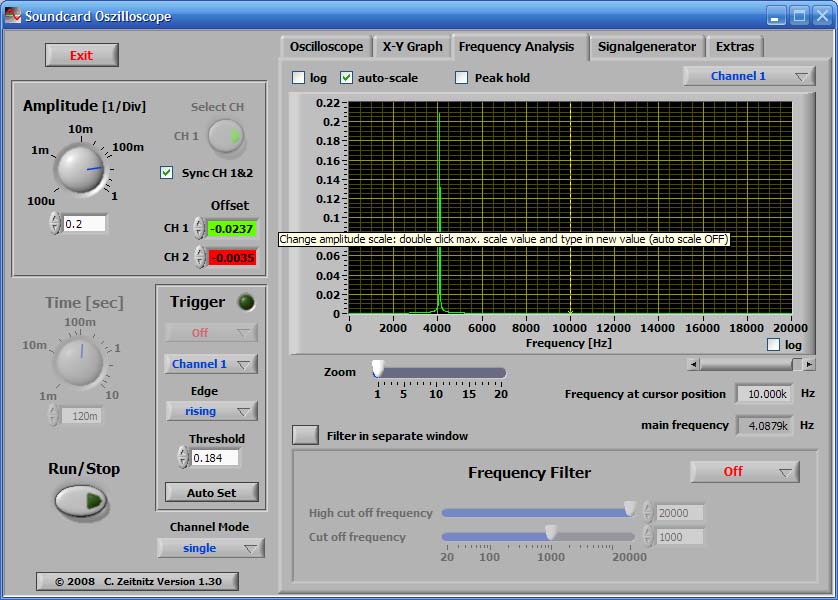

Here is the program I'm using to capture the signal it's very useful not just a scope but a sig gen and spectrum analyser too!
http://zeitnitz.de/Christian/Scope/Scope_en.html
