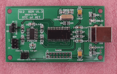

Following steps have been tested with Wayengineer TBDM (S12 BDM interface by AWNUXUE) based on MC908JB16 and silkscreened "S12 BDM v1.3, 2012-01-05, MTC of AIT". At least some cheap S12 BDMs on ebay appear to be same design so same instructions should apply for them.

I've programmed new SM and FreeEMS to Wayengineer 9S12XDP512 board using this BDM after firmware upgrade described above. Jumpers were "J4: BKGO SELECT as BDM1", "J6: VDD125 from Target: remove jumper" and "J5: VDD125 from USB: install jumper".
