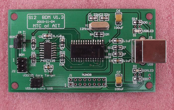

Following steps have been tested with Wayengineer TBDM (S12 BDM interface by AWNUXUE) based on MC908JB16 and silkscreened "S12 BDM v1.3, 2012-01-05, MTC of AIT". At least some cheap S12 BDMs on ebay appear to be same design so same instructions should apply for them.
1. You must use 32-bit Windows XP to perform this
2. You must have Office 2010 installed - evaluation version is enough as it's only required for some unresolved dependency of USBICP.EXE
3. You can't use latest USBDM as support for JB16 has been broken for quite a while
4. USBDM developer has nuked all old versions from Sourceforge. I've proved links to working versions below.
  • Download and install USBDM 4.9.5 with default settings
    http://files.mpoli.fi/sekalaiset/usbdm/ ... 5b_Win.msi
  • Download USBDM_Win32_4_6a.zip from
    http://files.mpoli.fi/sekalaiset/usbdm/ ... 2_4_6a.zip
  • Extract USBDM_Win32_4_6a.zip
  • Plugin Wayengineer TBDM while pulling pin 10 of MON08 connector GND to initiate ICP mode
    Pin 10 is also known as MON_DATA, see "C:\Program Files\pgo\USBDM 4.9.5\FlashImages\JB16\OSBDMe.pdf" included in USBDM 4.9.5 package for pinout if necessary.
  • Install USBICP driver from USBDM_Win32_4_6a.zip "Win32\Freescale ICP Files"
  • TBDM should be detected as USB\VID_0425&PID_ff02 "Motorola JB16/JG16 ICP Device"
  • If it comes up as USB\VID_0425&PID_1000 then you failed to initiate ICP mode
  • Launch USBDM_Win32_4_6a\Win32\Freescale ICP Files\USBICP.EXE
  • Select "Initial_Programming_MassErase.imp" when asked to open file
  • Next browse to "C:\Program Files\pgo\USBDM 4.9.5\FlashImages\JB16" and select USBDM_JB16.s19
  • Go thru Erase, Program, Verify and close USBICP
  • Unplug TBDM
  • Uninstall USBDM 4.9.5
  • Download and install 4.9.4 as it's last version with working JB16 support
    http://files.mpoli.fi/sekalaiset/usbdm/ ... 4b_Win.msi
  • Plug TBDM back without grounding pin 10
  • New device will be detected, point driver install wizard to
    "C:\Program Files\pgo\USBDM 4.9.4\USBDM_Drivers\Drivers"
  • New USB ID should be VID_16D0&PID_0567 and name "USBDM BDM Interface"
  • You can now follow regular USBDM docs. Programmer will also work with 32-bit and 64-bit Win7 now.

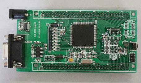

I've programmed new SM and FreeEMS to Wayengineer 9S12XDP512 board using this BDM after firmware upgrade described above. Jumpers were "J4: BKGO SELECT as BDM1", "J6: VDD125 from Target: remove jumper" and "J5: VDD125 from USB: install jumper".
Wayengineer 9S12XDP512 board can communicate with EMStudio, but that's it. Haven't done any further testing.

Did anyone used this with elmicro MC9S12XDP512 board?
I followed this steps and could upgrade the TBDM firmware but It can't detect the MC9S12XDP512 board.

I can program my elmicro card with a BDM just fine. No need for an external 5V supply if I feed it through the BDM.
There are two 6-pin headers on the elmicro card, X1 and X8. Are you sure you have the BDM cable on the X1 which is the BDM port?

Yes, I followed your guide (http://roller.baboonplanet.com/garage/e ... irmware_on). It's very good explained.
I tried to supply 5V also from BDM closing the two jumpers of the JB16 as is said in it datasheet, and in fact, I get 5V on elmicro card header with the multimeter.
But the HCS12 flash programmer says "The target appears to have no power. Please supply power to the target. Retry?"
But it has 5V..
If I don't apply the 5V from BDM the error is different "Failed to connect to target", the same I get if I disconnect the cable. If I then apply the 5V from an external source gives the same error that before "The target appears to have no power. Please supply power to the target. Retry?"
This happens also in Linux or Win XP.
In the elmicro card, should any led power ON when you apply 5V? In mine none.
thanks.

Yes, it's a blank mcu. No leds should be on. The only led on the board is connected to the PH7 pin and does nothing until your software decides to.

I checked the cable and it's ok and also rechecked the voltage and some schemas and I don't find anything wrong. So I'm seriously considering sending Fred my card.

Got it (BDM and S12), couldn't make his BDM work, used mine, loaded seank.hacked SM and will send back later today. Didn't/couldn't load fw due to no serial or usb connection.
