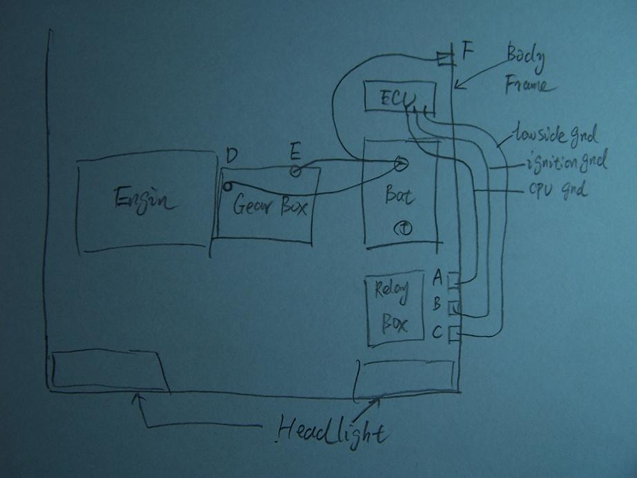

I spend the whole day with my friend to study the real harness of my car. We remove the OEM ECU and explore the connector pins against engine block using a multimeter. Then I draw this diagram.
I think the center of the gnd start is not the engine block but left side of body frame, there is quit a distance between F and ABC. About D and E, I think it is the return path of oil pressure switch and a CHT sensor(not the one for ECU). I think it is very wrong, but it works most of the time. I start to suspect that the car was so sensitive to the whether condition had something to do with noisy sensor?

Look at my weired OEM gnd layout

D and E also supply the negative connection to your starter motor, however you're right, usually the temperature gauge has a dirty "we don't care" ground in this fashion too.
The F ABC distance shouldn't be an issue, the body is likely a fairly low resistance conductor for your purposes. The main thing is what you do with those three wires. See other thread for my thoughts/questions on that.

The OEM ground wiring looks OK to me! If you make sure that the three wires from the ECU to the chassis are wisely used and correctly connected you'll be fine :-)
