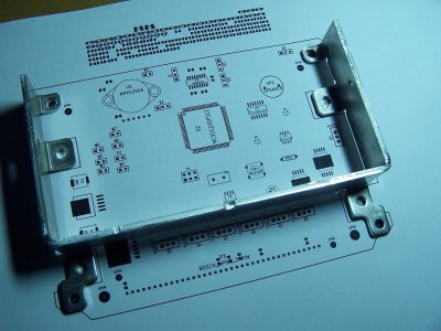

Excellent heat sink to mount vnp10n07, I should go semi sequential fuel injection A lot of effort was put on making the board geometry compatible with stock ECU

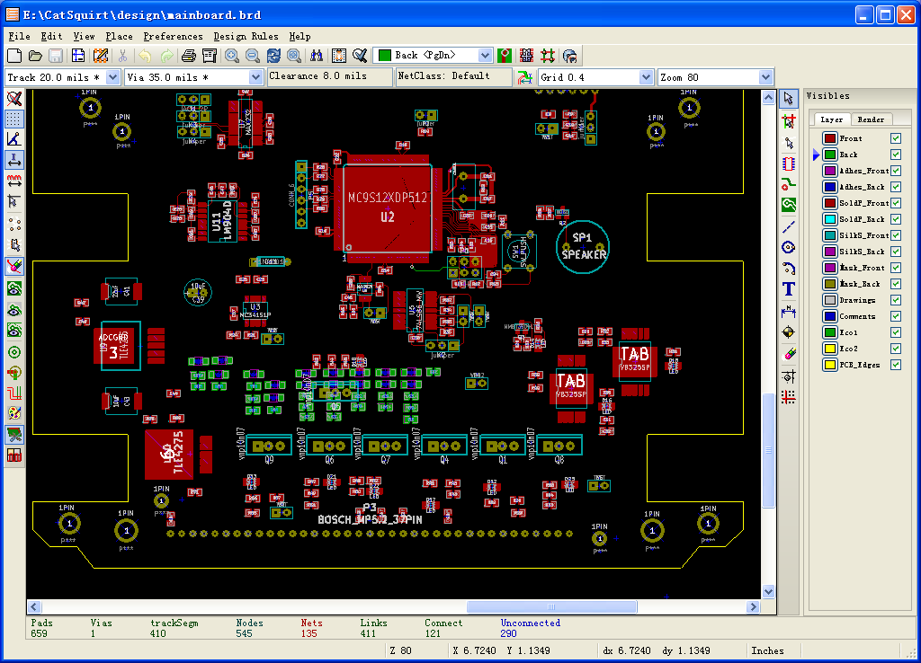

I think my FireCat schema work will be locked down, each sheet was heavily revised according to your discussion and claim. Yes, you are right, none of the subcircuit of Puma board is 100% right, they are either lack of capacitances or the marked value was incorrect.
I remove many unessential interfaces such as narrow band O2, VSS input, AC relay control. And make my injection circuit configurable either to be batch fired or semi sequential fired. I use screwed connector to connect wide band O2 input and custom injector wire

You should keep the relay control and any general IO that you have pins for. Keep the VSS stuff on PT7 too, I'd love to see you hacking that to work. It just won't be official for a while/long time, that's all. This isn't necessarily about being official, though... :-)
Before you go printing boards, I'd like to have a look at your schems in a PDF and I'd also like Dan and Preston and Huff and others to take a look for you. Let's make it as good as it can be! :-)

This is my HW specs that I've committed to readme.MD of my git repo
Core IO specs:
1 RPM/Position VR for 60-2 wheel pattern
6 Standard 'CORE' analog inputs(IAT,CHIT,TPS,EXO,BRV,MAP)
2 ignition drives for 4 cylinders wasted spark(PT2,PT3)
2 injector drives(HI-Z ONLY). Can setup to either do semi sequential fuel injection or do batch injection(PT4,PT5)
1 Fuel Pump relay drive.
1 dash board tacheometer drive.
1 pair of idle air valve drive.
1 gas tank ventilation valve drive.
1 switched +5V output for TPS.
5 Ground connections(CPU,Ignition,Analog Sensors, O2 Sensor and Lowside drives)
1 "12V" connections to power 2 voltage regulators
Special effort was put on making PCB geometry nearly identical as OEM ECU and reuse OEM metal case, connector and aluminium frame for heat sink. It is a mixture of SMD and through hole so that it can be assembled at home and it is almost plug and play for my Citroen ZX

What do you need an O2 sensor ground for? That worries me. That should typically have its own controller which grounds independently and just shares a signal line. Heater grounds for built in O2 stuff should be isolated.
The code is currently too ineffecient to run past 3k RPM. When you get closer I'll put some time into optimising it or producing a simpler version for 60-2 users and high RPM users on lower counts. I know how, so don't worry.HotCat wrote:1 RPM/Position VR for 60-2 wheel pattern

CPU, analogue should be one ground, but it comes in from the head/block/battery for the CPU and then goes out to the sensors from the ECU. ignition drive should share CPU ground IF it's low current. If it's high current, it should be isolated. Injector and low side ground(s) should be isolated.5 Ground connections(CPU,Ignition,Analog Sensors, O2 Sensor and Lowside drives)
