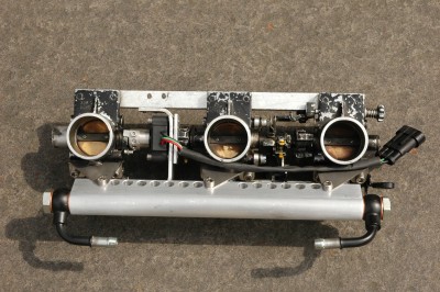

Using this one its between the first and second ITB.
Its universal, for D shaped axel.
If someone is interested i will dig up the specs.
Sensor is Vishay 971-0001 is also available whit connector (-0002).
See 971. pdf
Fits D-shaped 8mm axle.
Kawasaki GPZ1100 B2 throttle bodies.

Yes, please edit the post with what it's from (brand, model, engine, year) and the end-to-end resistance. Let's keep the signal to noise ratio as high as possible (no extra unnecessary posts).
