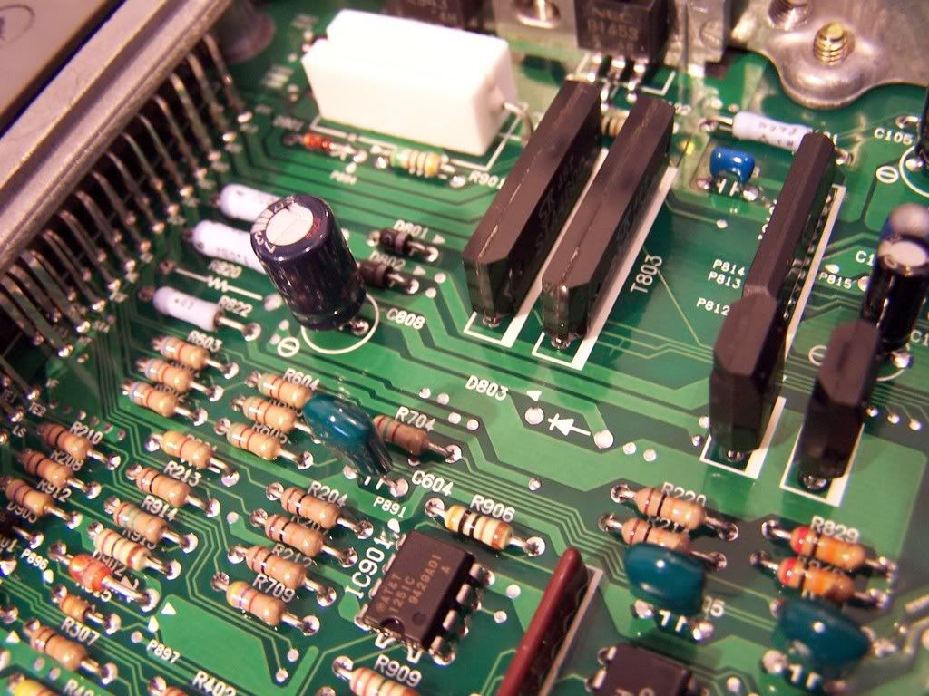

The injectors are driven by a pair of these http://www.sanken-ele.co.jp/en/prod/sem ... a460ce.pdf
Which have built in diodes for protection. There are no external components, just direct drive by those chips and let the injector do as it pleases to the extent allowed by the internal clamps.
One of the to220 devices appears to be the controller for the heater circuit of the O2 sensor, but I haven't confirmed that yet.

Hmmm, looks like a large resistor next door to the injector driver. How close to 70R is it?
Re: DIYEFI.org temporary test mule (No 56k)
The injector drivers are shown in this picture :
http://i260.photobucket.com/albums/ii15 ... 0_8643.jpg
They are SIL chips. You can see the four thickish traces leading towards the connector from them.
I think one of those to220 devices is the switch for the O2 heater. Not sure about the other.
The resistor is pretty far from 70 Ohm ;-) 0.1 Ohm actually. It's for coupling two grounds together and possibly current sensing I guess. I didn't pay it much attention really. I was looking for ways we could change our design to benefit from Toyota's wisdom and specific functionality and how it was implemented and how to connect to it. I found all of those things and am now ready to do on car testing in the near future, even if it's only basic stuff. Mission accomplished :-)
