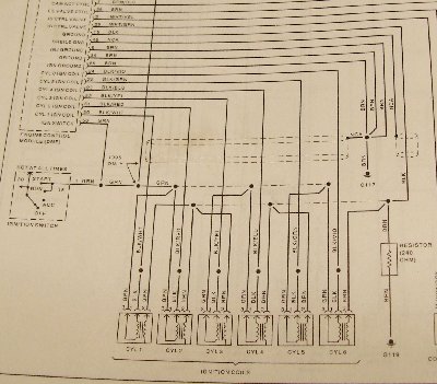

I will try and get the motronic schematic uploaded tonight to explain better. and yes it is on the ground side of the secondary.

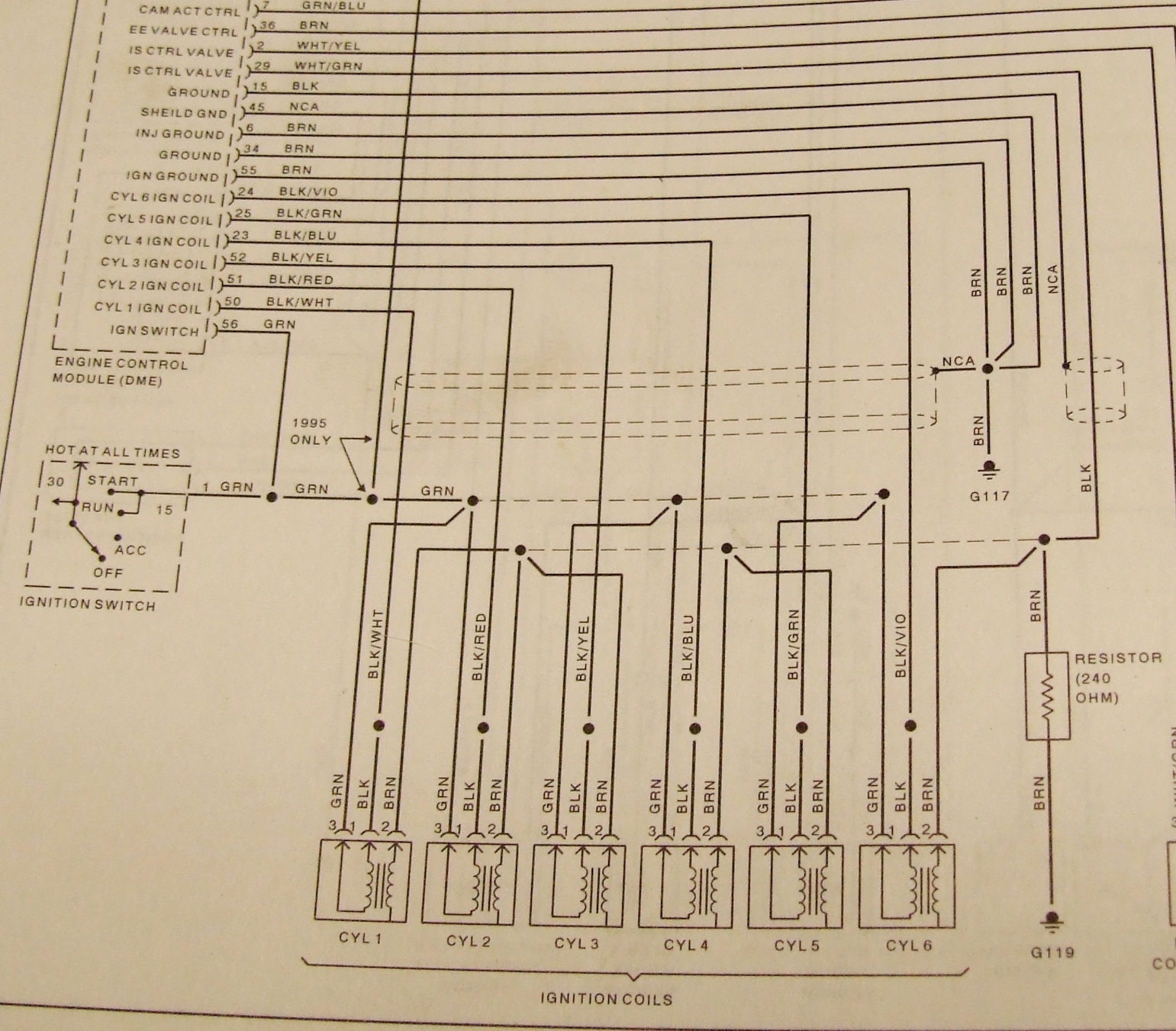

OK here we go notice the 240R and the screened signal cable going back to the ECU which carries the voltage drop across the resistor when the spark current is flowing.
