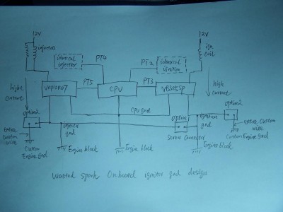

Fred wrote:When you say "ignition ground" what sort of ignition system do you have? Is it distributor or wasted spark or what? Does the OEM ECU drive the coil directly (terrible idea) or through an ignitor? If it drives the coil directly, then you need to either share grounds with the other low side stuff or have one for ign, one for other low side, and one for CPU. I'm going to assume that it uses an ignitor, though:
Unfortunately, my OEM Bosch ECU adopts on board ignitor design, it drives the coil directly. So I assign one pin for onboard ignitor, one pin for injector and all lowsides and one pin for CPU. See my diagram
Ahhhh, stepper! OK, you actually need a stepper controller chip connected to those pins, a lot like Marcos did in Puma. You could try to drive a stepper directly, but it's much better not to. I was going to say google, but let me find you a link or two.
Oh, my mistake, my idle valve is not a smart stepper motor, it can't maintain its position after power off. It is not necessary to use a smart chip to drive it. Just two PWM is enough

That is a beautiful diagram! :-)
My final recommendation to go with that is to make sure that it's easy to bridge the three grounds in any combination. Particularly, make sure that you can join the ign and inj grounds to share current capacity as your coil ground path will be under a lot of load and if the connector pins aren't designed for that load it could give you headaches. Make sense?
As for the not-a-stepper idle valve, is it necessary to drive those PWMs independently? Perhaps include an inverter IC such that you can either drive the second FET from the CPU OR from the same channel as the first FET but through an inverter.
Ravage is setup like this such that people who don't have 3 wire setups can get an extra independent output but toyota/bmw people can use a simple single PWM output to correctly drive the valve.

Fred wrote: My final recommendation to go with that is to make sure that it's easy to bridge the three grounds in any combination. Particularly, make sure that you can join the ign and inj grounds to share current capacity as your coil ground path will be under a lot of load and if the connector pins aren't designed for that load it could give you headaches. Make sense?
Your final recommendation is very important, I have two options to address this issue.
1.use a screw connector to joint the ignition and injector low side.
2.use dedicated gnd wire to split current for ignition and low side.
So I extend my diagram as following, which one is better?
this is my 2 pins screw connector
and look at my OEM connector, I think such a single thin pin can not sink ignition current efficiently.
I intend to have FreeEMS control my daily driven car, so I think it is worth to spend more times to address issues earlier.
When power off, the value stations at middle of the position, So it is possible to drive one side coil of the motor but still need some experiment. As the pin resource is rich for my design, So I decide to use two PWM channels to drive my valve

HotCat, I made a mistake when I looked at your first diagram that I described as beautiful. You tricked me with four connections to each of your devices. I'm going to edit your diagram to fix it and post it here later. Sorry about that.
Re: Is it OK to use one vnp10n07 to drive four high-Z inject
Hotcat, here are the corrected images with totally isolated grounds. Firstly, the devices have only 3 pins anyway, secondly the ground should only be connected at the engine/chassis/battery.
First image:
Second image with options:
Note, the second one does not have a connection where the cpu ground goes down and the option ground wire crosses.
I hope that makes sense.

Fred wrote:Hotcat, here are the corrected images with totally isolated grounds. Firstly, the devices have only 3 pins anyway, secondly the ground should only be connected at the engine/chassis/battery.
That's my silly mistake, my VB325SP ignition chip do have separate gnd design, so I mistakenly copy to the vnp10n07 diagram. Look at my ignition schema, you are not 100% right
