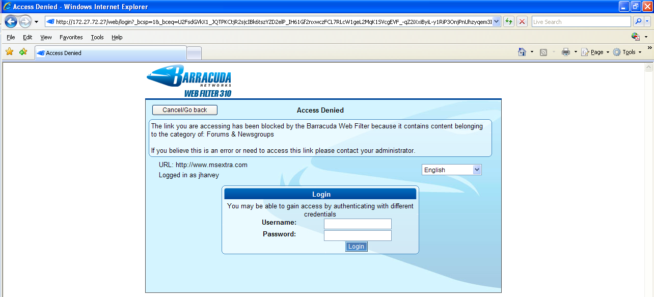

Re: FreeEMS hardware feature wishlist (your suggestions here!)
This is the first time I've been happy to see the baracuda blocking content.
