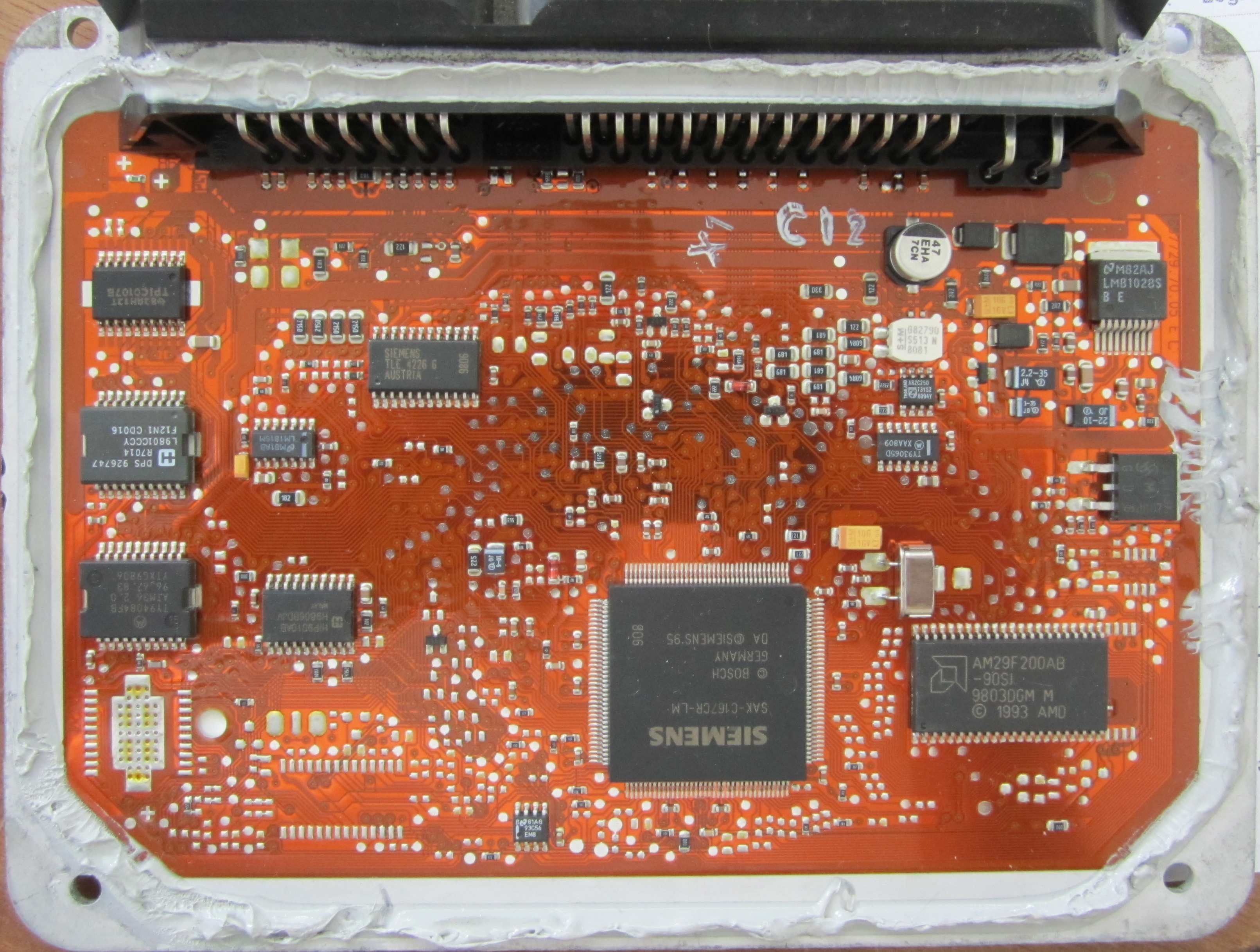

Re: Knock sensing ideas and circuit designs
HIP9010AB are inside in a Siemens 5WP485904 (audi a3 8L)russian wrote:Does anyone know which cars use either HIP9011 or TPIC8101 in their stock ECU?
there is also an LM1815M inside
see picture below
