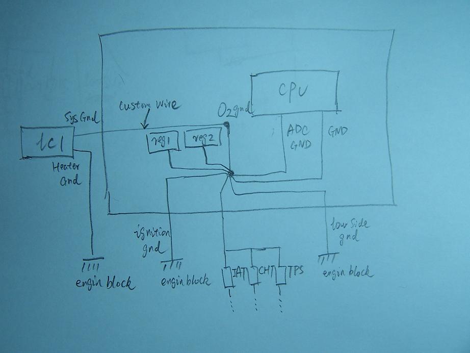

I draw a diagram represent my GND design

The grounding is very wrong, like MS grounding, which causes a lot of trouble.
You CAN ground your LC-1 like that, no problem, but you don't need to. It should have a ground shared with the block, just like the ECU and LC1 heater.
You can't have a looped star system. You can have more than one star.
The ground for the low side drivers especially the injectors should be a totally separate circuit and wire all the way back to the block.
The sensor ground is good.
The ignition ground.... do you have ignitors? Or are you driving your coils directly from IGBTs or darlingtons inside the case?
I suspect that you have ignitors and that ignition ground is CPU/reference ground. Am I right? If so, the only thing you need to do is split the low side ground off from the rest of the grounds and treat it like it was in another box. If you're worried about the voltage sag causing in effective switching of them, then run an ADC channel to the low side ground so you can monitor it in logs, like RavAGE.
If that doesn't make sense, please ask again :-)

I copy the looped star system from my OEM ECU, in Bosch's design, injector drive gnd, low side gnd, on board ignition drive gnd, sensor gnd, sensor wire shield gnd, CPU gnd were internally connected together forming a start connection. Center of the start was the voltage regulator
I previously made a assumption that OEM design was always correct and it runs my engine for a decade without failure. If doing so is very wrong, I should follow your suggestion and separate the injector gnd, on board igniter gnd. Made them only connect the OEM pins which lead all the way to the engine block.
and is it necessary to separate the injector gnd from low side gnd? According to my study on OEM harness, the ECU only fan out 2 pins that connect to the block directly
Re: Is it OK to use one vnp10n07 to drive four high-Z inject
If you only have two pins connecting to the block independently, use one for cpu ground and the other for high current low side ground. You can make a provision to join them together later if you wish.
The OEM made a choice. They realised that the impact on sensor readings only extends to the battery voltage and that you can filter that in hw and software enough to not matter. I prefer a more accurate approach of not allowing the low side currents to disrupt the reference ground and cause the 12v signal to appear different to reality.
You may go which ever way you choose, however if you go with star inside ecu and high current shared with reference, don't complain to me when you've got noise on your signals.
One ground for injectors, idle, etc is fine. No need to split them off, really.
having the remaining stuff star at the Vreg is ideal, though, so keep that aspect.
Re the 3 wire valve, that's the same as BMW and toyota. The plan of attack there, and what the BMW ECU does, and likely the toyota too, and the Ravage schems is to use one high resolution PWM and an inverter IC such that it works like this: 50/50 30/70 10/90 etc. If you want to run it with two independent signals and write code to handle that scenario, that's cool, I guess. Custom code will always be cool, but it won't always be integrated. Are you certain that two cpu pins control those two outputs? and not some logic like bmw (also bosch) and ravage are doing?

Fred wrote:If you only have two pins connecting to the block independently, use one for cpu ground and the other for high current low side ground. You can make a provision to join them together later if you wish.
Today, I comfired that three pins connecting to the block independently. So I have one ignition gnd, one low side gnd as well as CPU gnd.
I'll go the right way and won't let your down
Yes, one dedicated gnd for injectors and all low sides
I am pretty sure about that, here is a diagram
When you say "ignition ground" what sort of ignition system do you have? Is it distributor or wasted spark or what? Does the OEM ECU drive the coil directly (terrible idea) or through an ignitor? If it drives the coil directly, then you need to either share grounds with the other low side stuff or have one for ign, one for other low side, and one for CPU. I'm going to assume that it uses an ignitor, though:
"Yes, one dedicated gnd for injectors and all low sides" Perfect, now you just need to decide if you use two pins for that or only one and use two for the reference ground. Likely you'll want to use two pins for the high current stuff and just make sure the other one is in good condition. Make sense?
Ahhhh, stepper! OK, you actually need a stepper controller chip connected to those pins, a lot like Marcos did in Puma. You could try to drive a stepper directly, but it's much better not to. I was going to say google, but let me find you a link or two.
