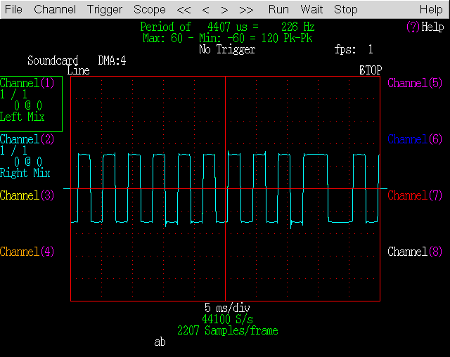

I guess my point is I expected to see two wide pulses. The picture that you posted has only one.
My LPT sym looks like this.

The signal you show is what you get when you hook up your VR with the polarity back to front. It would be extremely hard to detect that at speed even if you meant to :-)
