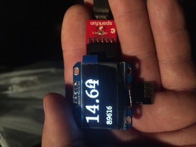

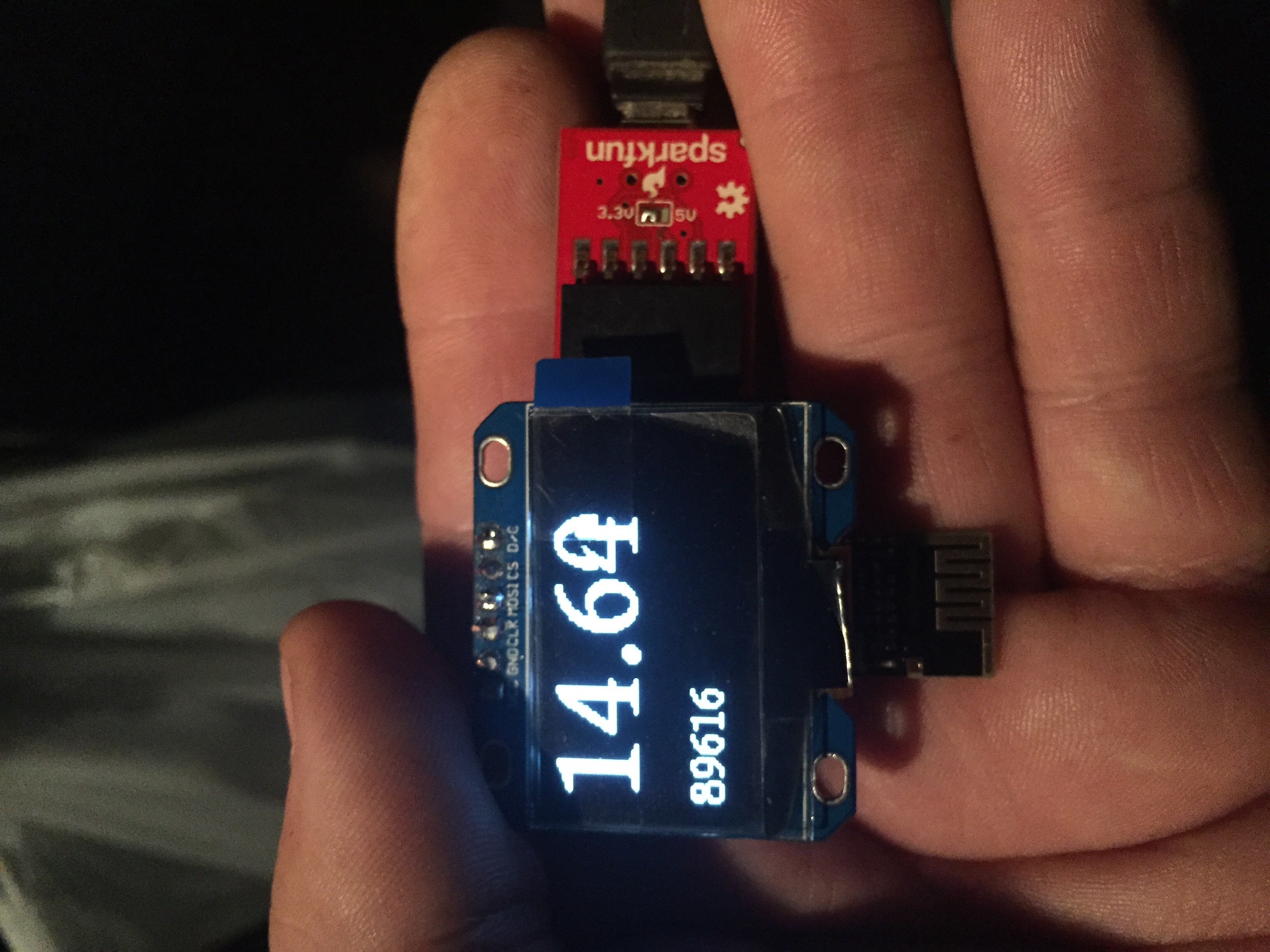

Pic of the display, pro-mini is mounted behind it, and radio is poking out the bottom.

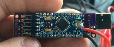

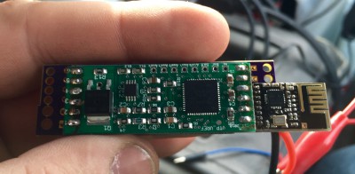

I have some boards in the way, there are 3 total.
One board is the same width as the SLC, but slightly longer, the SLC mounts to the back side of the board and the Pro mini mounts to the front side. There is input voltage protection and a 3.3v regulator for the radio transceiver, it also has a header to mount the radio.

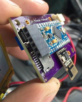

The 3rd board is for the display, it's a similar "sandwich" layout, with the OLED mounting on the front and its Pro mini mounting on the rear, it also has a micro USB, a micro SD card slot, LI-Po charging circuit and a radio header.

Posts: 39
Moar pics:
Mon Dec 28, 2015 10:27 pm
Joined: Wed Oct 01, 2014 7:06 am
Posts: 39
First two pics are the SLC interface board, front and back. Not shown is the aux input board that will stack on top of the pro mini.

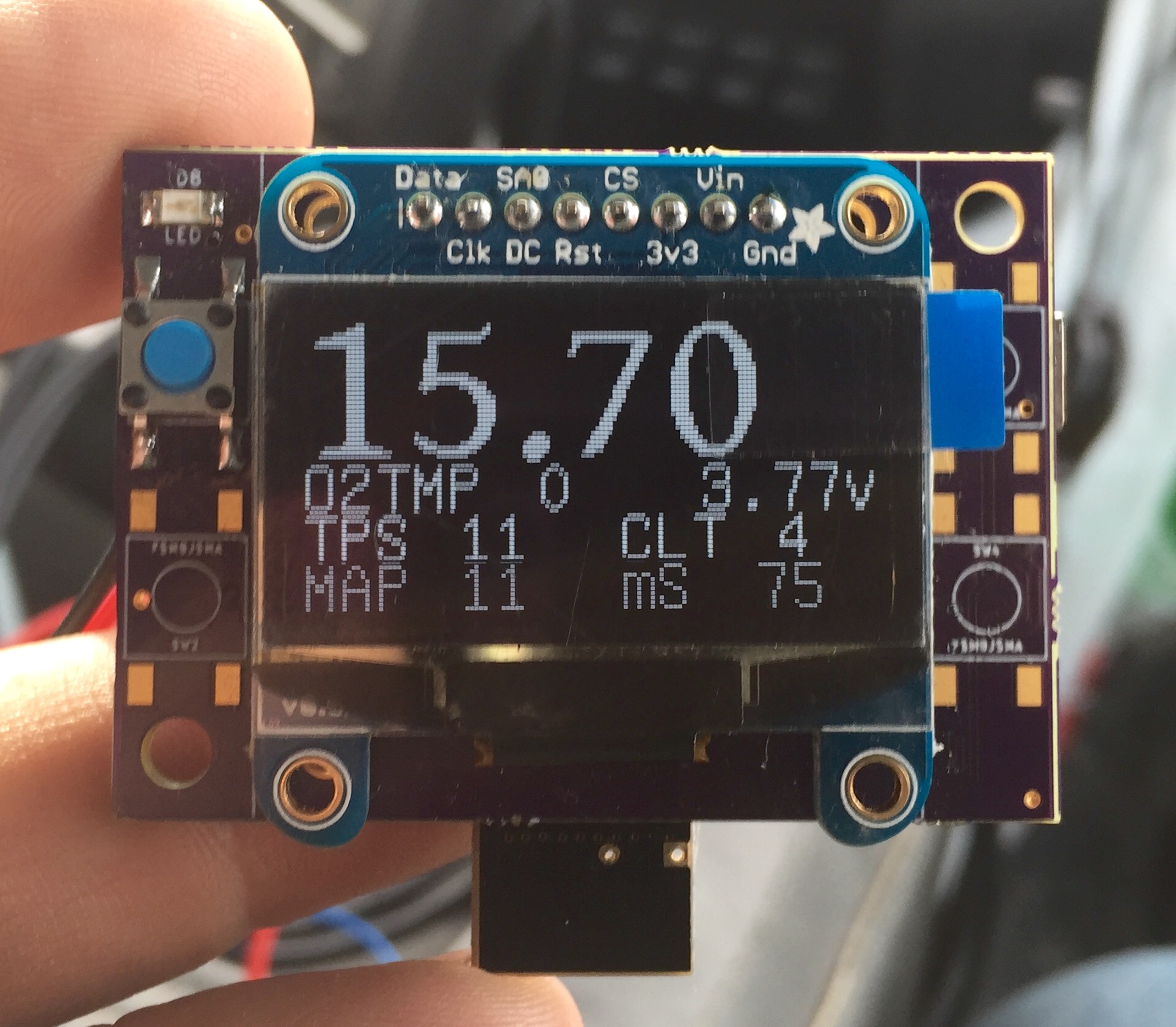

Lower pic is the battery powered display board, the values displayed are the real values ( scaled ) being transmitted from the SLC transmitter module.

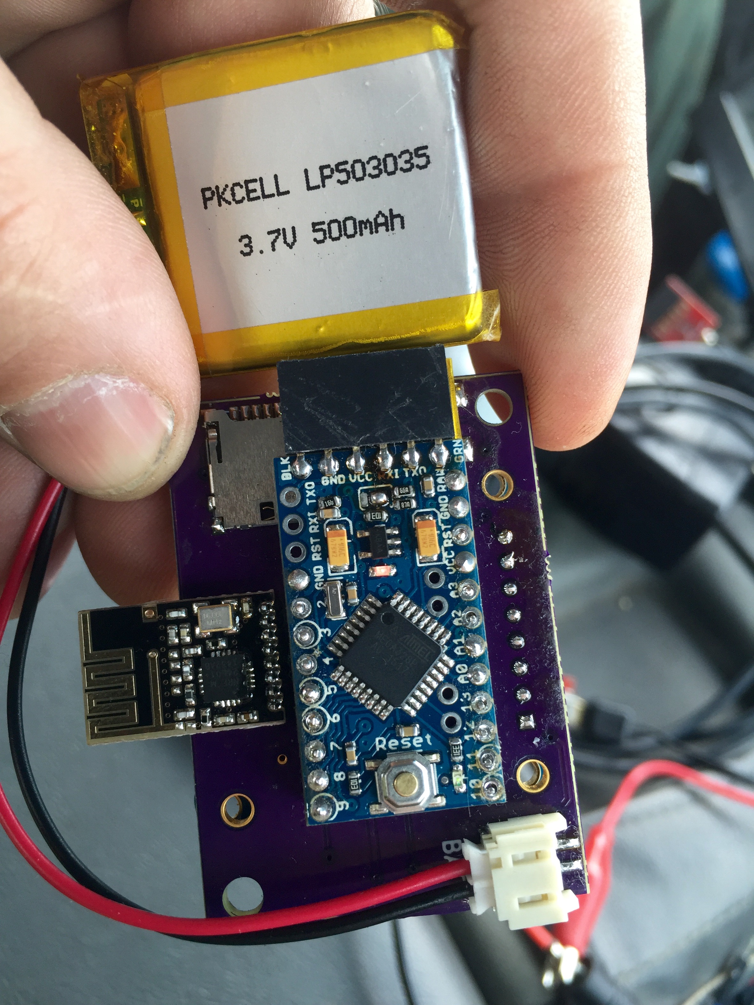

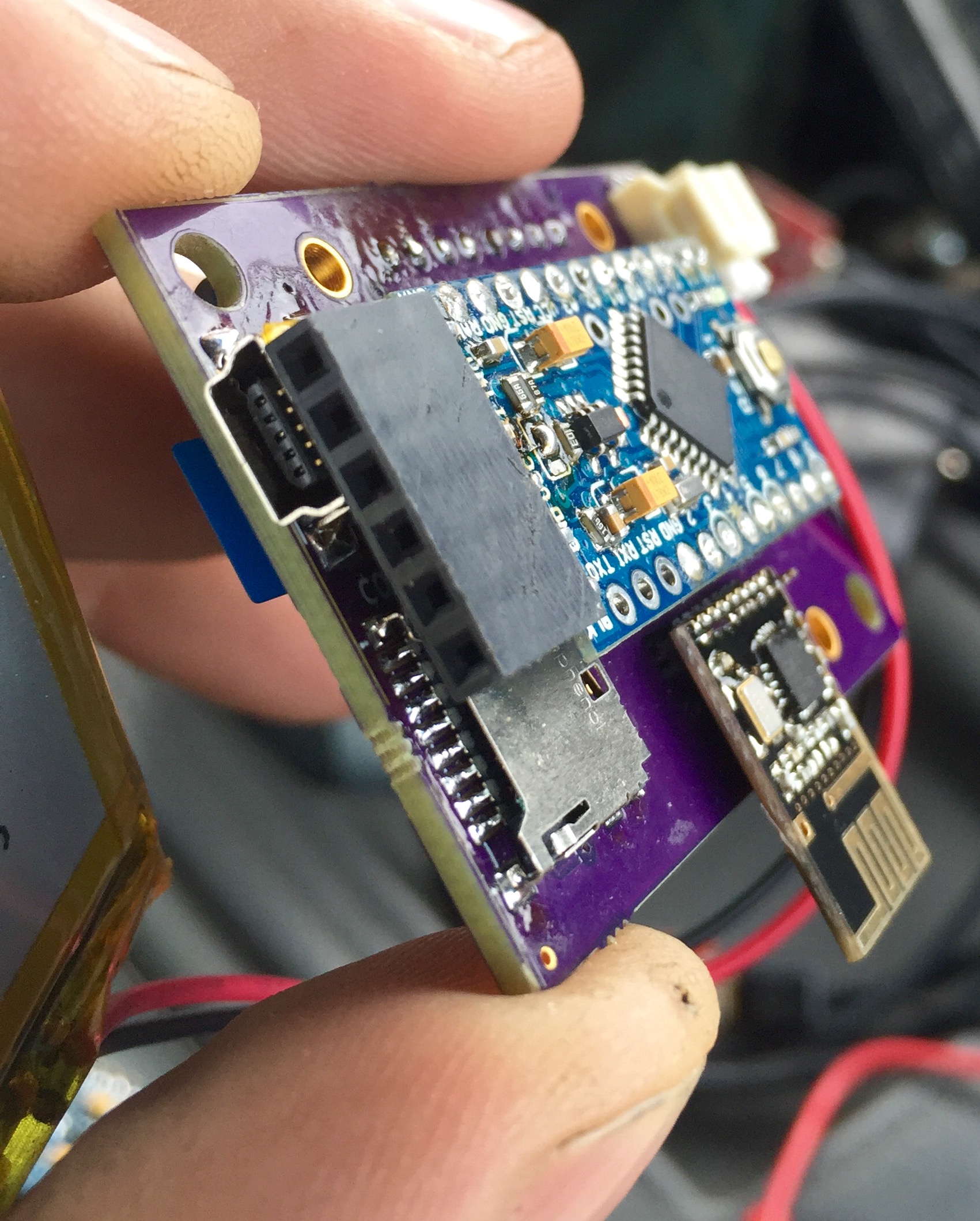

I'll get a pick or two of the back of the module as well, to show the SD card and mini USB charging port.
File comment: SD card slot and micro USB for charging.
File comment: Back of display showing lipo battery

Posts: 39
Only have the power button mounted for now, but there will be 3 more added, these will be used to start and stop data logging and to scale the various inputs.
