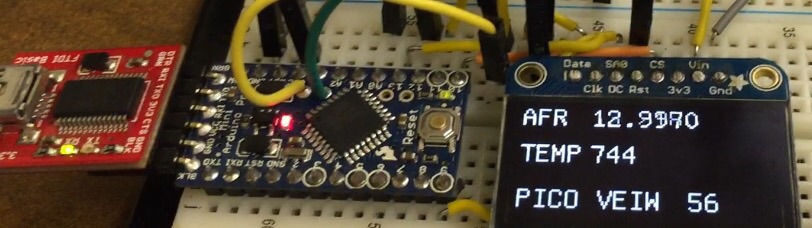

Got a pic of it off a video I took, haven't had time yet to start on the wireless part but the wireless boards arrived a few days ago. If work schedule permits I hope to get that done and start working on casing it all up.
So far I'm really impressed with the little SLC OEM boards, hard to justify the arduino project I'm working on when these are only $40.... But it's fun to play with.
If I could figure out a way to implement a wireless I2C link that might make for a cool combination, a single (optionaly) battery powered micro running a display and possibly data logging talking wirelessly to to one or more O2 sensors that are simply an SLC, voltage reg and a $2 transmitter......
