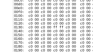

Setting cells in RAM works :-)
But burning it down to flash didn't. Need to investigate that...
Disable datalog sending works too.
